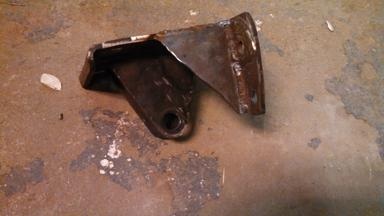

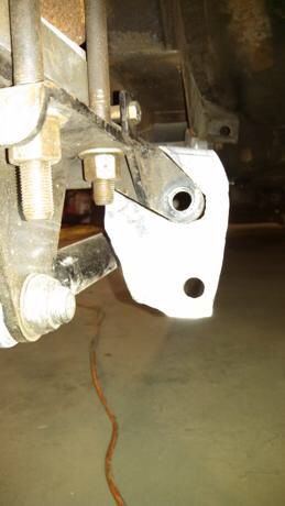

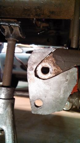

I have a question? Been trying to make since of the spring reaction in front of the axle. Every thing I read says at launch the rotational force of the axle housing will push the front of the spring up at the front eye and I am not doubting that to be correct. The explanation needed is I broke the drivers side main leaf at the front part of the eyelet which at still motion leaves to weight of the vehicle on the spring but when loading the drive train in a forward gear the body would separate off the leaf spring instead of it being forced into it. Why?

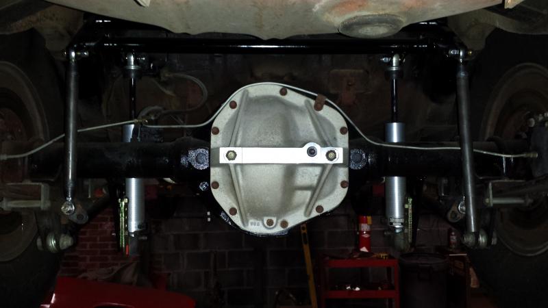

Switching from Caltracs on my 65 light blue dodge, to Caltracs, mind you same engine, I went 9.29@145 mph on Caltracs with a 1.36-1.37 60 foot.
Then putting on a ladder bar setup with a good double adjustable went 9.22@146 with a 1.27 60 foot, no other change.

image.jpgimage.jpgimage.jpgimage.jpg These were made by Dap (Rob) for his Duster
Those are shocks not coilovers! So again why would I want to go that route and spend $700.00 of my hard earned money on something that may or may not work

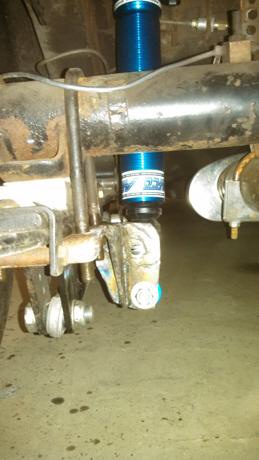

Look closely at the shock you will see the thread for the spanner nuts that hold the spring you can use this shock either way
View attachment 236497this is how I mounted my shock
#1 link attachment doesn't work
#2. like I said before those shocks are way too long for my ladder bar setup. I want my car to sit lower in the back and my wheels tucked into the wheel wells.
I'd have to cut my trunk floor to use a shock that long.
image.jpgI used shock mounting kit given to me by Dap the shock position can be mounted in many different configurations it's an ART kit all I'm saying it's not hard or expensive to switch
