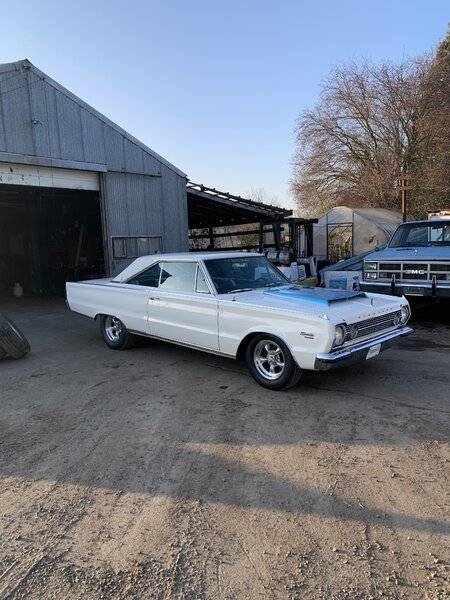

I have 275/60/15s on15x8 polished torque thrust with custom 5inch backspace with no other mods on my 66 satellite and they fit perfect no rubbing at all.

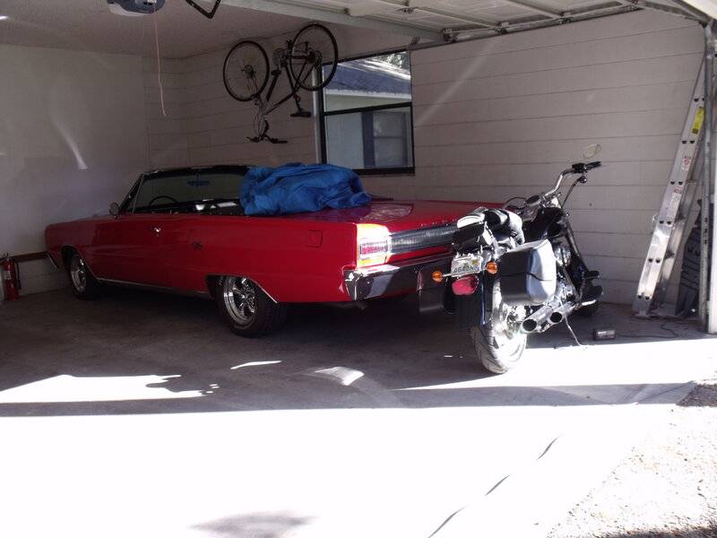

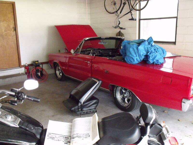

Nice ride, what are the specs on your wheels and tires?
Rear: 15 x 8 with 5 1/4" BS... I would order 5 1/8" BS the next time..
Front 15 X 7.. I cant remember BS? It was 4" or 3 3/4.. Not as critical as the rear..
I have 245-60's on the rear.. Largest tire I could get in without wheel well problems.. I see people on here all the time claiming they have 275's and the only thing I can figure is they are "downhill" cars.. My car does sit fairly low
If I jack up the rear of the car, from the third member ( rear end) I cannot get my wheel off.. The jack has to be on the "frame" to get enough clearance to remove the wheel...
I have 275/60/15s on15x8 polished torque thrust with custom 5inch backspace with no other mods on my 66 satellite and they fit perfect no rubbing at all.View attachment 1180016
