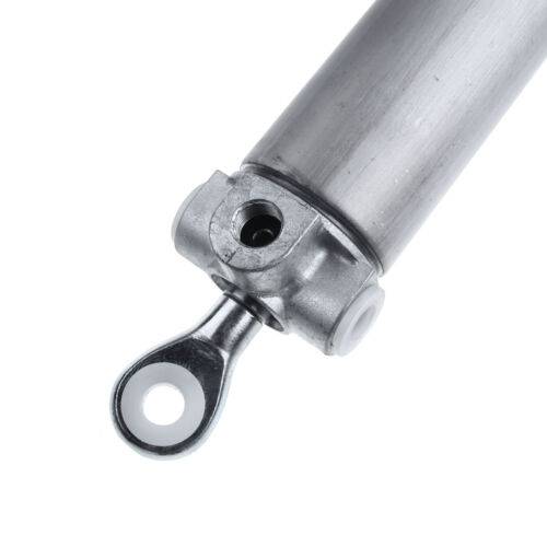

I'm sure you know they're $139 ea from a seller on ebay. Any local hydraulic rebuild service and supply? Your shafts have to be in good shape.
Rebuilt many hydraulic cylinders in my life but never anything as small as convertible top cylinders. If all that is wrong with them are seals and you can get them apart and get replacement parts it is fairly easy. If something is crimped, the barrel or rod scored or parts unavailable that will make it difficult. You also have to look at cost. We had some snow plow cylinders that by the time you bought a kit and figured an hours worth of labor you had more in it than the cost of a new one.
The head flange is secured to the tube with a rolled bead,....Not designed to be rebuilt.. For the cost of new ones it's not worth getting deep into repairing them...
Thanks for pointing that detail out. At a glance I thought the end caps were threaded.

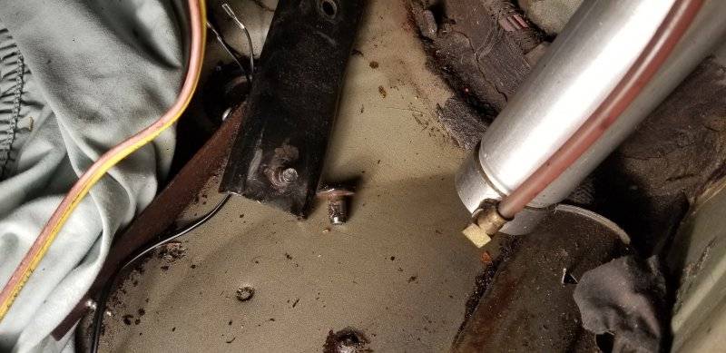

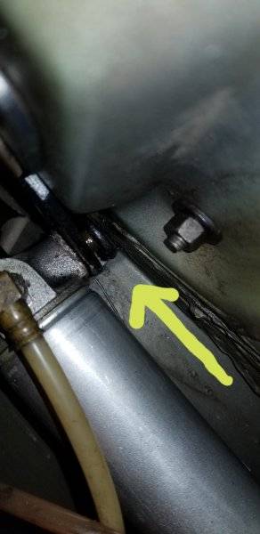

What do you know about the pins that the piston hangs from. Pic shows pin closest to body shell backing out.
After further investigation, pin that is loose seems to need 3 tabs to press fit pin to top assembly. I would guess locating this small part is about a bazillion:1?
Those three spots are spot welds... Just weld it back on the frame...
