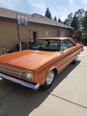

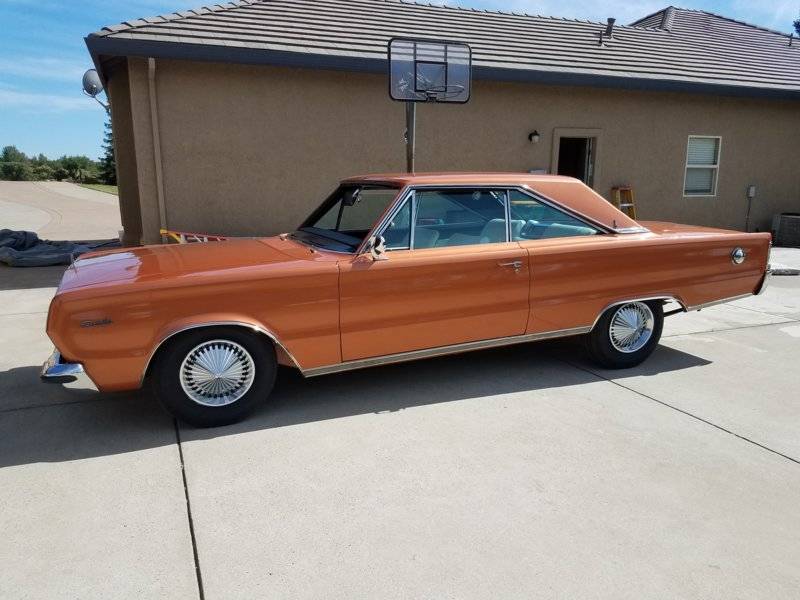

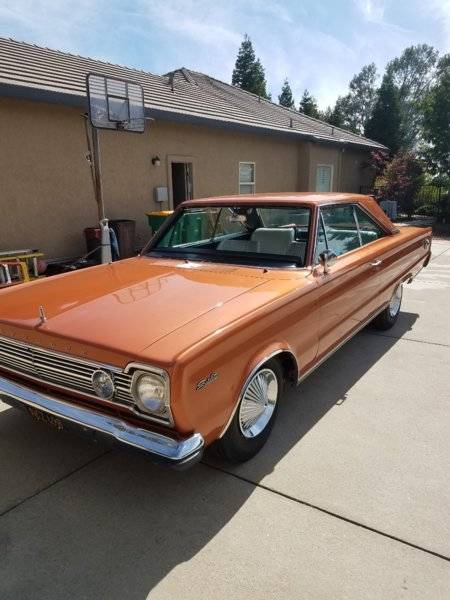

I started years ago maybe 2004 not sure with Abodiesonly. I picked up a 1966 Satellite in 2016. Same picture on both sites.
