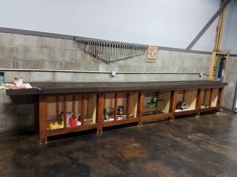

Since I'll be doing all types of fab work including welding I didn't think epoxy would be a good choice and instead acid stained mine then sealed it. My thoughts were epoxy burns and will get burn marks all over it from the welding whereas sealer should hold up better, be easier to touch up and can be waxed as well. My floor was stained to mimic natural stone/slate so the variety of color also makes blemishes less noticeable. I can take a better pic but this is all I have at the moment.View attachment 646662

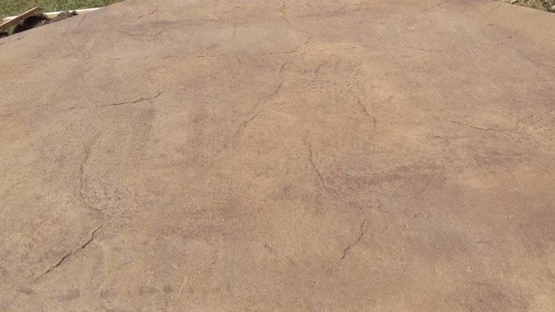

This is the outdoor pad we did for our corn crib gazebo. Dye in the truck and then 2 different colored release powders before stamping then pressure washed when dried. A sealer was sprayed on after this pic was taken. That really brings out the color.
