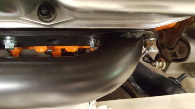

I just installed my new TTI headers using studs. (906 heads too)
Reason for using studs is to have some more insurance against cooling water leaks from the stud holes.
The shoulder of the stud tightens up against the head which should provide a good seal.
And i used Permatex on the stud threads when installing them.
I measured what total length is required to keep them as short as possible to ease installation in the car.
The longer they are the higher the engine needs to be raised to get the header installed/removed.
