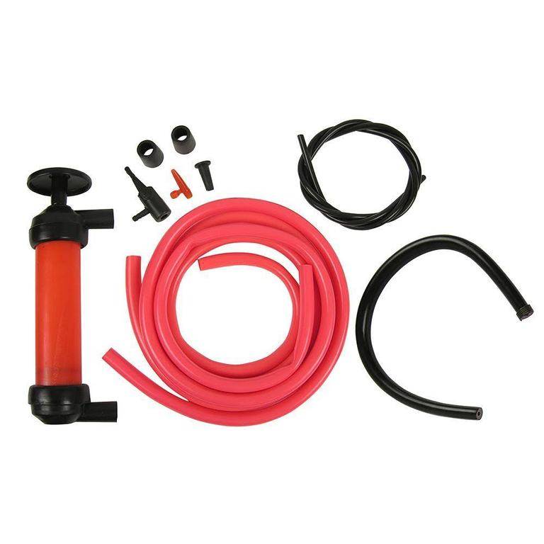

                  I just drained my tank using one of these. They are $10 at Home Depot. Just replace the crappy hose they come with with some better hose for another $5 or so and they work great.
                  Mine pulled out about 11 gallons from the tank pretty quickly, and when I dropped it there was about 1/2-3/4 of a gallon left inside, which wasn't bad.
                  As for the ring, I bought a new tank that was made in Canada and a new sender made in China. Both came with rings and both were identical. They looked to be about the same as the stock ring, but I opted to reuse the stock ring anyway and no leaks.
                  • Like Like x 1
