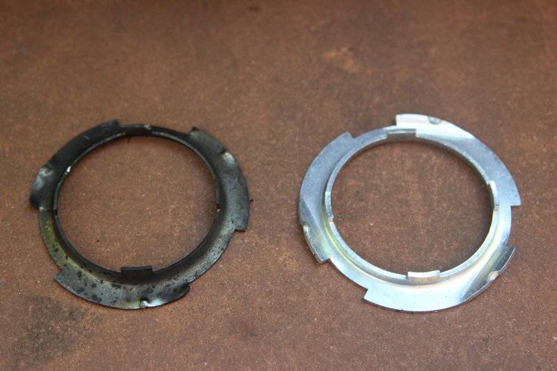

        I have used this stuff (Hi Tack) for years. It cleans up very easy with Lacquer Thinner. It never gets completely hard. Ref my post #29. It held up about a year and started leaking again.
        Save yourself the grief and replace your lock ring with an OEM equivalent.

        This is an update. Do not waste your effort. It will leak with using sealer. Been there done it also.

          I replaced my old gas tank with a new aftermarket, using the old ring and the high tack sealant to hold it in place while installing. I tried multiple times without the sealant, but couldn’t keep it into position. Agreed, the new retaining rings are junk.

          I agree, When I changed my tank out the aftermarket ring was not tight, I used the original ring I think I bent up the tank side flanges to make it fit much tighter. I only used the gasket its been 5 years so far so good.

          I just replaced my tank with one from YearOne
          The locking ring was extremely tight
          We even had to fight with it to get it to lock in where we wanted it

            I noticed the difference between the original and the aftermarket but I just bent the tangs up on the aftermarket one and it made a noticeable difference in fitment and haven't had any issue with it leaking.
