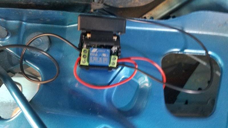

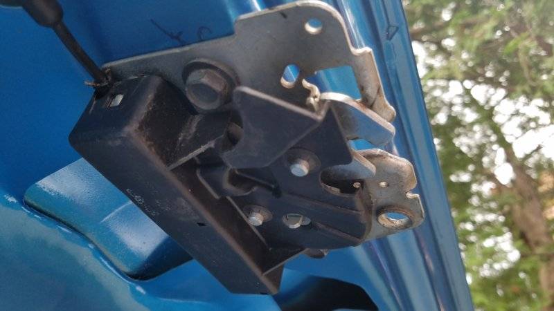

I bet I get into my trunk 2 or 3 dozen times on a car show weekend. Why not have a remote control? I bought a used electric latch from a newer Mopar, bolted it in and wired up the transmitter/receiver that I bought off Ebay for less than $10. Works great and no more fumbling for my keys or scratching the paint.

Awesome! What was the newer donor Mopar?
I don't even know. I just bought it from a guy on FABO if I remember correctly. I would imagine many of the 80's Mopars would have one on. I think Classic Industries has them for around $50.
The Diplomats and 5th Avenue cars used them too.

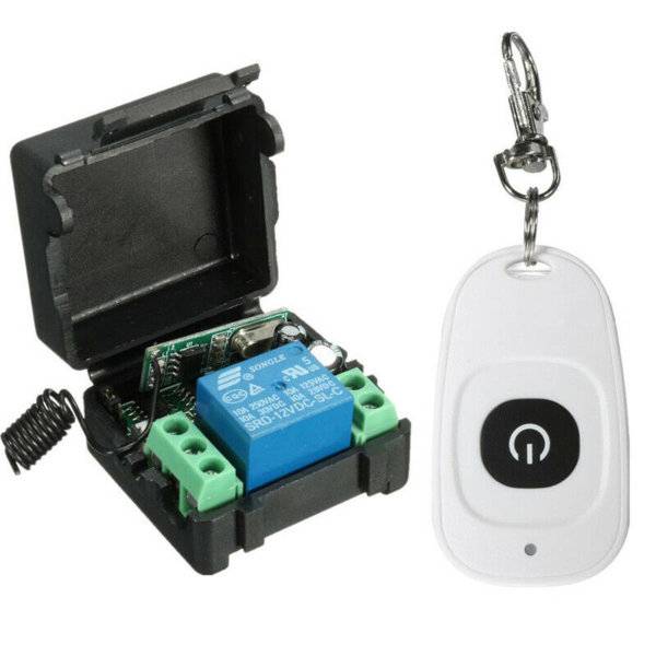

Can you list the part # and manufacturer of the remote. I see the Songle name but couldn’t pin point the one you used.

I think I grabbed one out of a C-body. Fit right in. I just recently posted on the Members Projects and Restorations thread (1968 Coronet RT) about how lucky I got running the wire for mine through the trunk lid. How did you run your wiring? I got a 3 channel remote. The other 2 channels are for lock/unlock the doors. Same reason as you stated for the trunk opener apply to door locks. I used after market actuators.

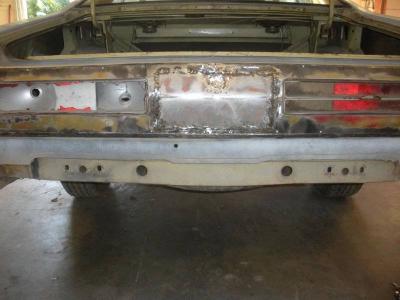

My Brother in law wanted it different. We used a pull cable and ran it through the car. It isn't finished yet but will be just forward of the LH seat belt retractor. I welded over the trunk lock hole too.

I used a piece of mechanics wire to fish the wire through. Power locks would be a great addition as well.

I'm sure there are hundreds of different ones. Mine didn't come with instructions but Google and You tube to the rescue. I assembled things loosely first and drew a schematic.
