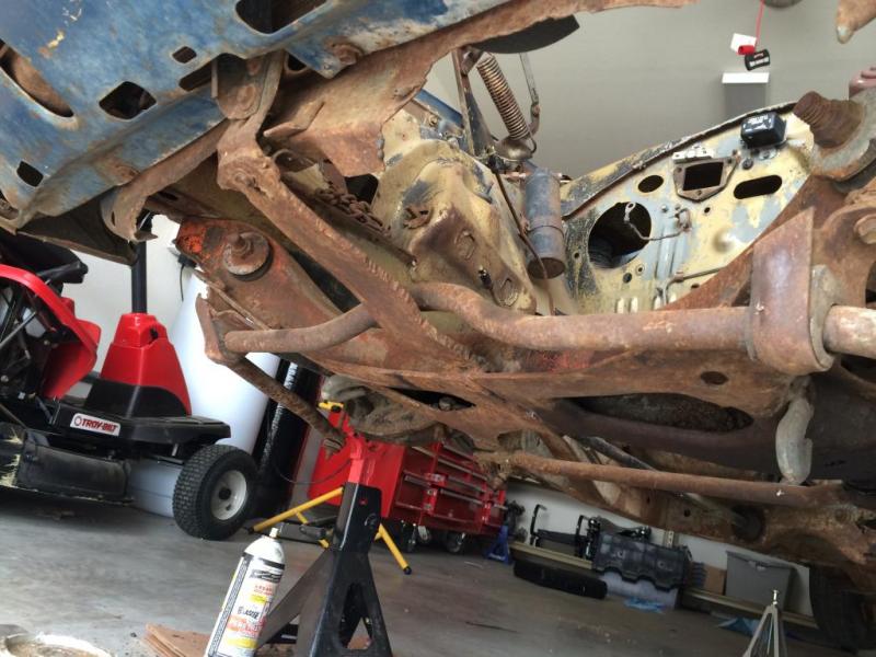

While removing the k member from my first mopar resto, a 68 Charger, the head of the k member bolt sheared off. I have drilled it out to no avail. I'm thinking I'm not going to be able to use a screw extractor and the best way at the moment is to cut open the side of the rail try to get it out through the top and salvage the nut.
There isnt enough sticking down to grab a hold of it. I've also tried welding bar stock to it after the holes were drilled to no avail.
It is the passenger front bolt.
Any help on recommendations is greatly appreciated!

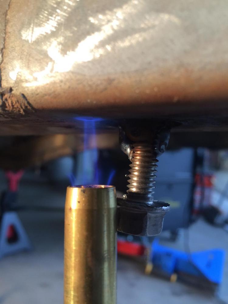

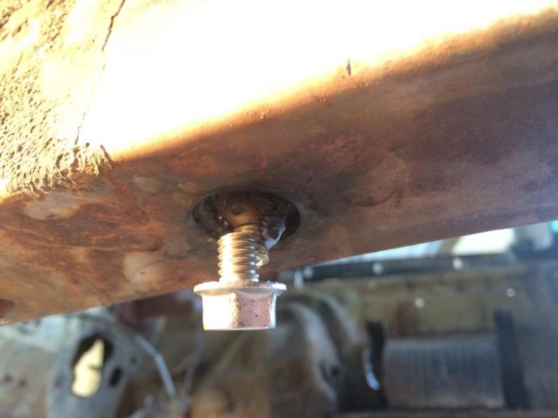

UPDATE: This friggin sucks. I tried welding a bolt into the hole I drilled...
and heated it...
and then this happened...
I should have tried a damn grade 8...I'm a bone head...

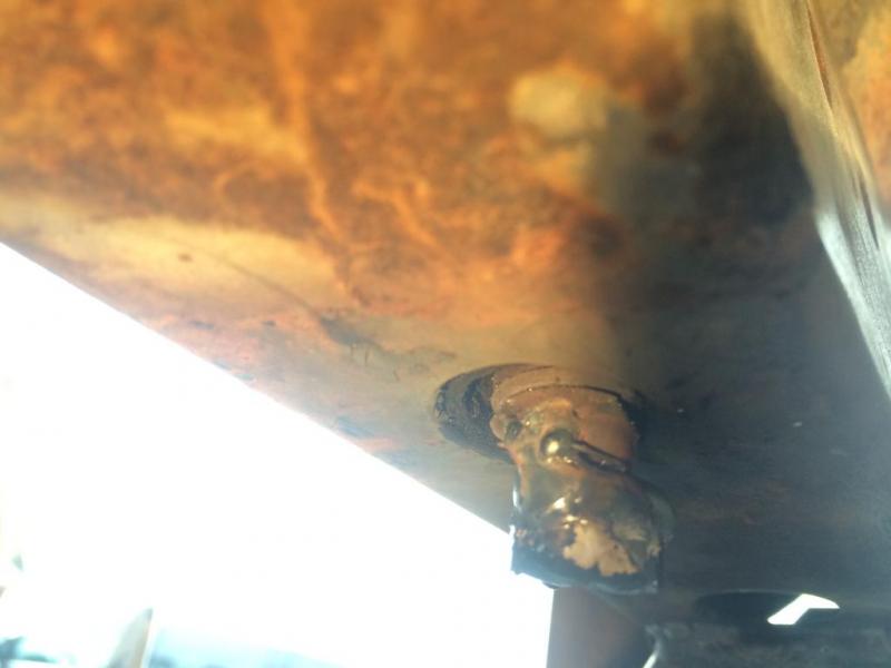

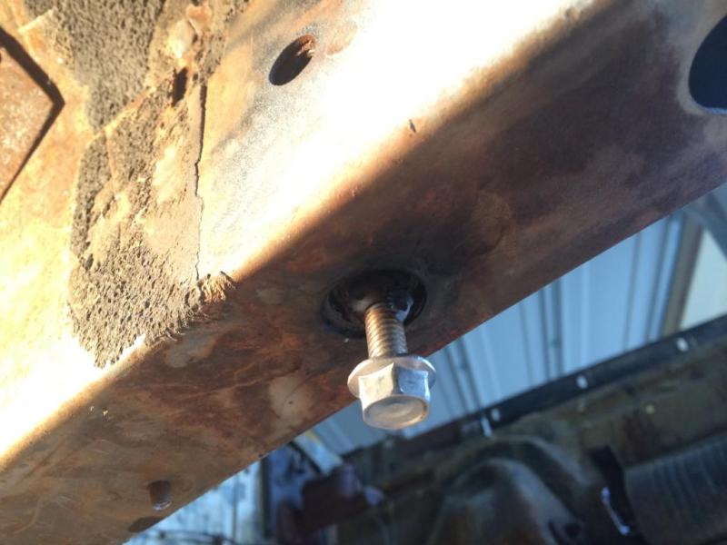

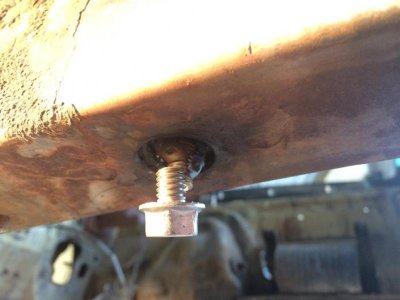

So I tried a nut...
Starting to look pretty ugly.
I am still tempted to open this part of the frame up...
The nut is now rounded....deep sigh...
Any recommendations at this point?

Grind off all that you have welded on already. Try welding a nut on again. It might take a couple of tries, but I have had great results using this method. I agree with the others, don't cut a hole in your frame.
I agree with hunt2elk.
It looks to me like after you have welded a bolt or nut on you are trying to use lots of force and now the other bolt breaks. Stop using gobs of force - you have to "worry" this guy out or you will continue to break stuff. Once you get another nut or bolt welded on, then work the penetrating oil, or wax or high heat. Wiggle or sharply tap the wrench back and forth - do not force it, or you will end up in the same place!
Good luck...
Use a half nut! Even if you have to grind one down, it's allot easier to get a good weld in a shallow hole rather than a deep hole. It looked like you were using a propane torch in the pic, if so likely not enough heat.

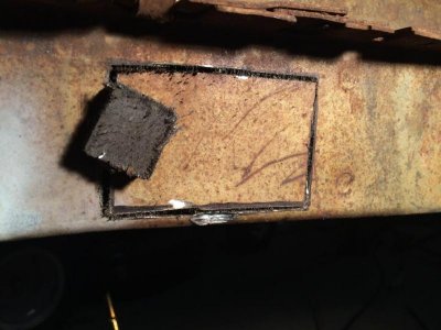

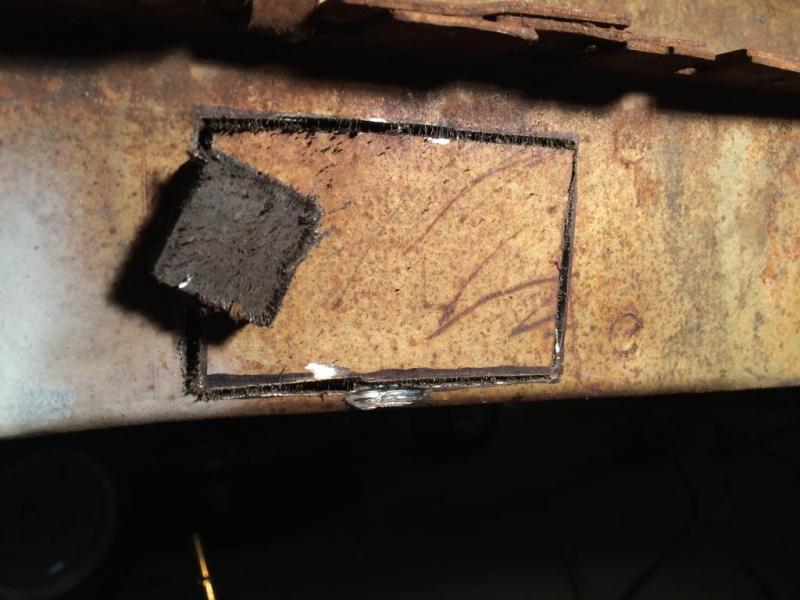

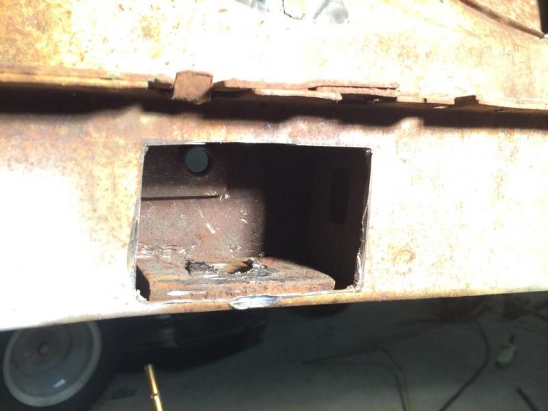

Well fellas I've got some bad news, after an entire frustrating day (10 hours of welding, heating, lube ect...) on one figgin bolt, I went against everyones recommendations and ended up cutting a window in the flat part of the frame. I concluded at some point in the past the bolt/nut were galled badly. The entire day I couldnt even get it to budge in either direction. Even with a 1/2 drive wrench before it sheared with heat and lube it didnt move a single bit loosening or tightening.
I feel bad for doing what you guys said not to, but its done, and not I have to deal with it. I plan on welding in a new nut obviously and cutting some 14ga flat stock and spot welding it to the inner edge of the "window" I cut. spot welding the piece back into place and then going around the edge. It should be even stronger than it was, and its flat so it shouldnt be noticed after being ground.

I REALLY didnt want to cut the frame either. But I also didnt want a galled up nut. Ah well. I will post the final weld up for ya'lls approval.
