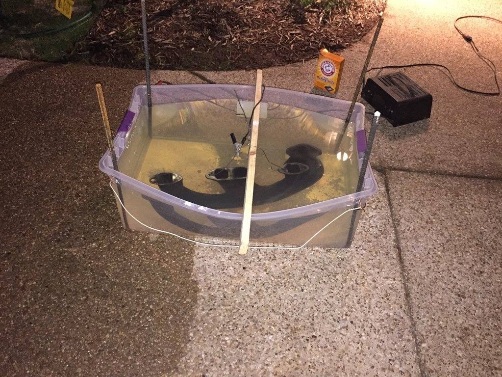

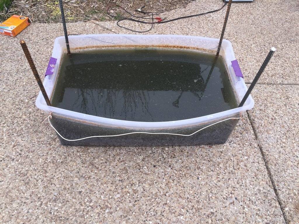

I been using white vinegar this spring and I'm pretty satisfied with the results so far. I'll post another method below, one I have yet to try. Your input is welcome.
With electricity.
I've done this one. It takes some time but works. Also needs to be done in a ventilated area.
