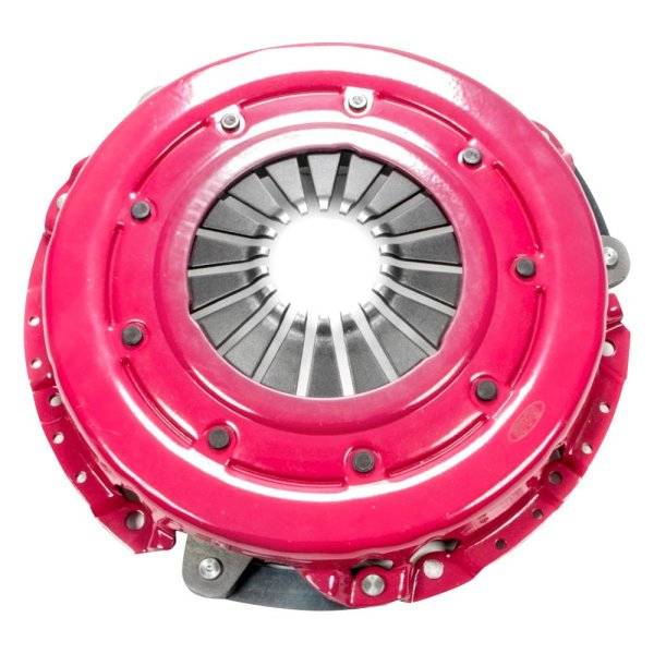

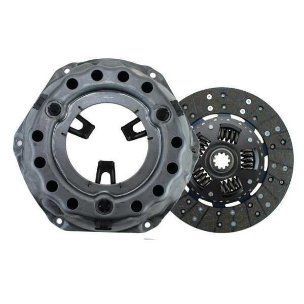

The spring isn't the problem... It's what's know as an over center spring.. It helps pop the pedal up the last couple inches, but past 2" it helps push down on the pedal....
If you have a diaphragm clutch you need to remove the spring..
I just installed the spring in my 64 Belvedere. I used the washers and stretched it out with hooking the spring to a floor jack and then pumped the jack up until the washers could be inserted.
I still have all my fingers.
Wild RT--not following you. Sounds you are right are right But can you elaborate?
Diaphragm clutch loose the spring..
OE style clutch keep the spring...
Got it--thanks for the photos. They explain everything. I had the clutch changed about 15 years ago and I don't recall which type was installed. But I know my throw out bearing has been making noise for a while now. So maybe its time to change it all out. I'll keep that new pedal spring on the shelf for now.
