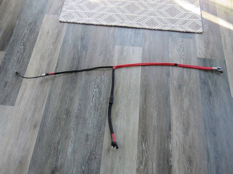

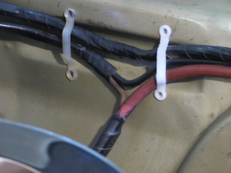

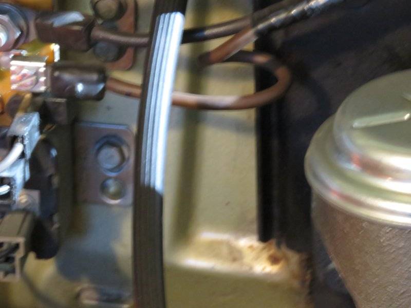

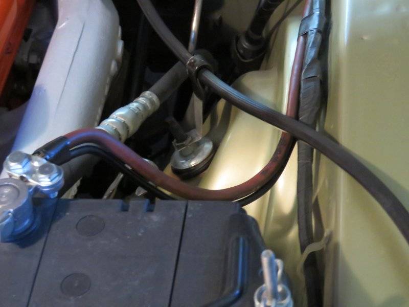

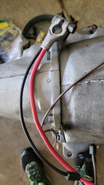

You would think they'd make the correct Positive Battery cable for 1966 Dodge Chargers and Coronets. But they don't. The leads at the battery should be red and black (not red and red), and the leads at the starter relay should be black and brown (not black and red). And, the repro cables mislabeled for 1966 Charger / Coronet are way too long. Come on repro guys --- this one should be easy.
You would think that the difficult part would be making sure the crimped ends are secure and tidy. :rolleyes:
