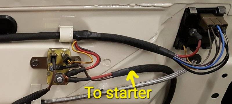

Cold weather caused me to run over add some antifreeze to the mix and start the cars. Forgot to remove the battery tender on one and created a mess somehow cooking the starter relay.
Replaced relay and reattached all wires and now no power entire car and even from the battery to the starter cables.
Removed all wires from relay and now have power back to the cables on the starter.
Looks like maybe something is causing a ground fault beyond the relay?
Here is my plan of attack next weekend.
Check all fuses.
Hook up only the one (small) red wire from the starter to relay and check for power.
If we have power, hook up neutral safety switch and check for power.
If we have power, hook up black solenoid wire and check for power.
Hook up violet and red wire to relay and power disappears problem is beyond relay?
Thoughts and suggestions?

Yes sir, we are exactly the same setup. Neutral Safety top left, ignition switch top right (yellow), horn switch is violet and red with it is ammeter. So far my guess is ammeter or ignition switch? Hope to find out this weekend.

Check the ole bulkhead connector too.
Will do. Its crazy. Losing all power with all the wires hooked up, took them off and full voltage at the starter. Ran out of daylight to troubleshoot.
'62 and '63 had actual buss bar on firewall connection for black and red ammeter wires. These were a better set up than later Packard connectors and rarely give any trouble. You might have cooked a fusible link. If you still have the original points-type voltage regulator, the fusible link is inside there. If you replace the mechanical regulator with a newer solid state one, you should add a fusible link wire to your circuit for protection. Good luck tracking it down.
I didn't know this! Learn something new everyday :thumbsup:
Success! Always last place you look! LOL. It was the alternator. After studying the schematic for the 100th time the Ammeter gets power from the starter relay then goes to the fuse block and also back to the Alternator. Pulled the Black wire off the alternator no more short and restored all the power and cranked it over. Have to replace the alternator now (pulling and installing the max wedge pulley again) wire it in and maybe the voltage regulator if it ate that too.
