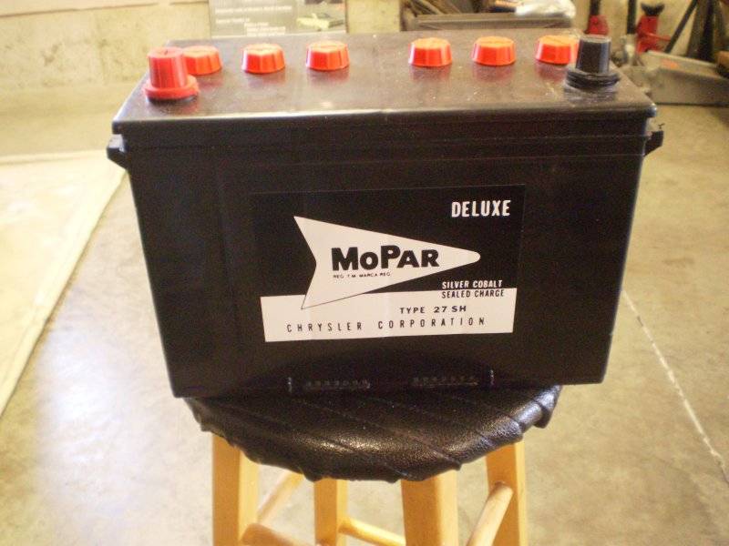

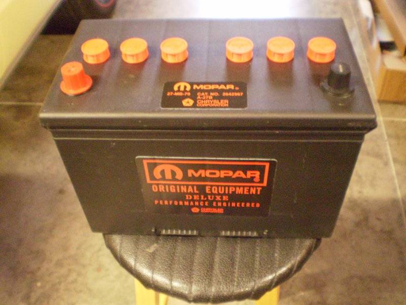

You need to check in more often..lol... I've shown it twice now how to gut and install an Odyssey PC925 inside. The case is bonded together. I've done both by opening the bottom, but if I do another one I'm going to run it thru a bandsaw right below the case tops lip.

Cheapest place to order an Odyssey in Canada is from saskbattery.com Free shipping even... I'm at camp so a bit handicapped. I bought the correct one the first time... pretty sure I ordered the same the 2nd time but was shipped a different version. Let me see if I can find my other battery build.

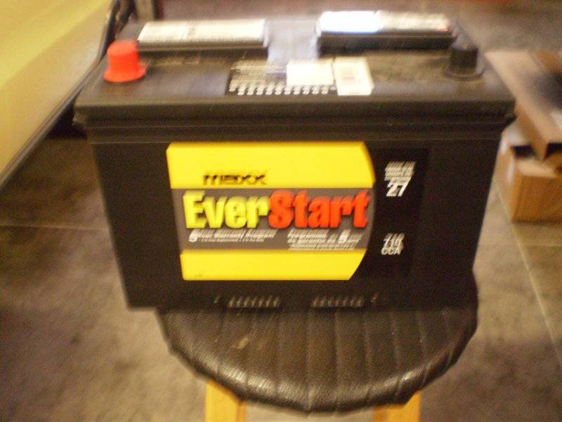

Walmart Group 27 battery with WeskCar cap and label kit.
