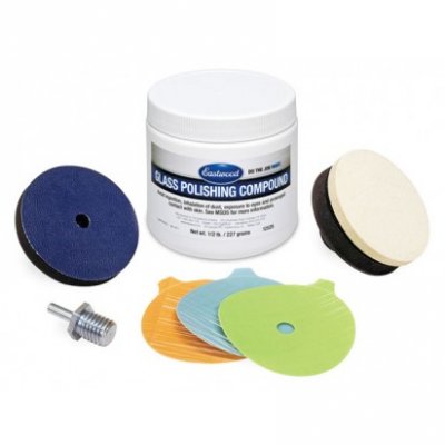

Another question, I am going to try to salvage as much glass as I can and saw they have buffing kits, anybody done this, how's it work? The retards that had this car blasted it with windows mirrors and all still installed, they even primed over some of it "retards". I'm not using them, I saved the glass out of a RR, luckily they didn't ruin my rear window.
Eastwood has a buffing kit for windows it works pretty well, sorry I don't remember the name or part #, I haven't use it for a couple years now either, but I did on my other 68 RR that I sold a few years back, you really need to have a good variable speed low RPM buffer & several different sizes/styles of buffing discs/pads to get all the glass really good, their kit is pretty basic & it will work with a variable speed drill.... they won't look like new, but will get most of the water spotting, chemicals or very minor nicks, pits & scratches, that aren't very deep out pretty well... It was worth the $50-60 I spent on the kit a while ago...
too high of a speed it will look really wavy

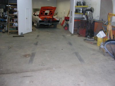

:hello2: Happy, Happy, Break in went very well with only a few minor issues that were quickly dealt with with only one left to resolve. It sure was a great feeling to sit the seat and DRIVE it outside under it's own power "leaving little burn outs everytime I poked the peddle" (don't worry I'm not hot rodding it, only fluctuating the rpm's to 2,500 just like they say). First issue as embarrasing as it is "I ran out of gas" (only been putting small amounts in because I don't know how long it will be in there). Second, it climbed up to 200 degrees, must have had trapped air because it took a gallon to top it off "stayed at 165 after that. Third, the power steering box is leaking out of the lock nut. All in all, a good day. DSCN8298.jpg

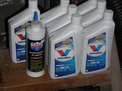

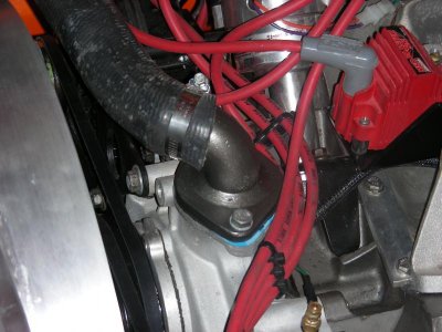

While it was apart my dad welded up all the multiple bolt holes in the water neck and then cut the excess aluminum off, not sure if I like the cast iron grey (same color as the motor) might repaint it aluminum. I figured I'd show what I used for my break in seeing how when I removed the first cam it looked great as well as the lifters. Figured out the power steering leak today now just have to resolve what I think might be an ignition switch problem. It's been doing it off and on, sometimes while cranking it it won't even try to start but as soon as you let go of the ignition it will fire as the starter disengages. I believe the run function of the switch may not be working in the start position making it fire as you let off but that will take two people to test. The plan this weekend is to finish the tips and get it wet sanded then drive it to the house for a bath, I'm waiting on the rump stripe for masking it off and then I'll be ready for paint. Started digging through my parts between the 68 RR and the Charger it looks like I have all of the glass I need but the windshield has a nasty scratch so I may not use it (the idiots that had this car blasted it with the door windows in it "good thing I saved the RR windows"). Also figured out what I'm using for headlight door openers (Ford 4X4 vacuum solenoids) they used two on an already made bracket and are readily available. Before you complain about FORD PARTS understand that I can't find a Mopar part to do it and the Ford ones have MADE IN THE USA cast right in them which to me is the important part. Once done it should make for a much cleaner look only requiring one hose.DSCN8297.jpgDSCN8299.jpgDSCN8305.jpg
