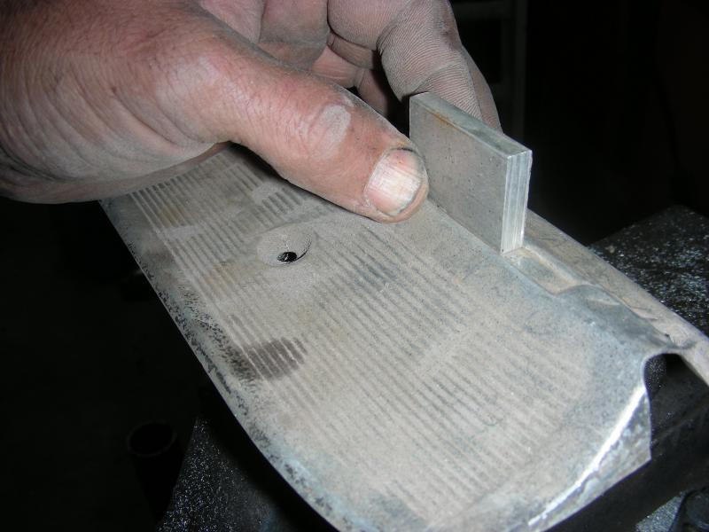

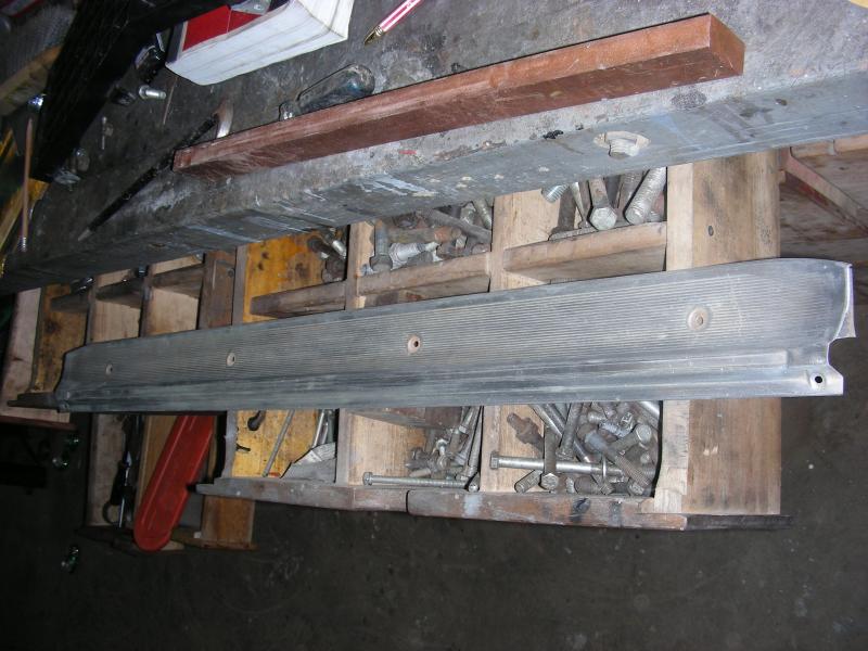

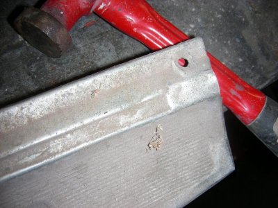

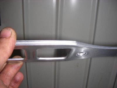

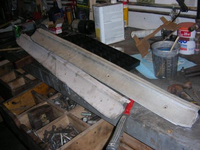

Not sure what I'm going to do with the deep scratches in the fluted part, maybe a triangle file? I am kinda liking the brushed look though, how would you keep it from oxidizing? I've just been sanding until I see a low spot then beat it out and keep repeating, easily manipulated and sanded and shouldn't be to hard to make them nice again. For those who haven't used the Percey gaskets here's what they look like.

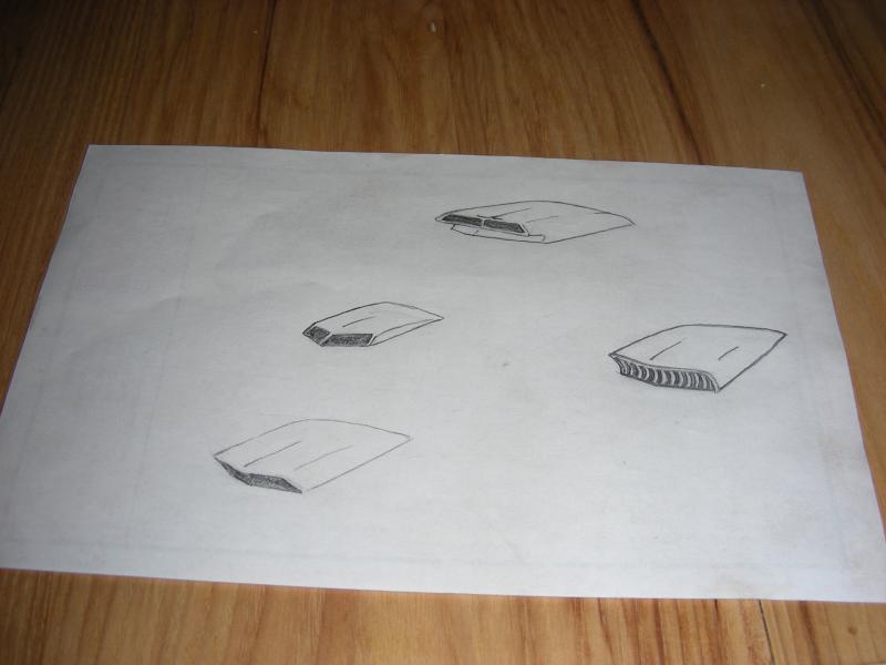

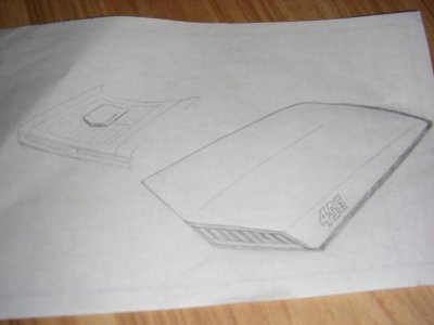

Personally I like the idea of the 6-pack looking scoop you drew. Only scoop I've ever really thought looked good on a Charger hood other than maybe a hemi scoop. A 6 pack style shaker would be pretty cool I think

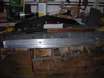

And I feel your pain on straightening the sill plates. I've been working on the I-beam trim from my grille that was all beat to crap for the past 2 days, a few hours after work, and it's finally resembling a nice straight piece. The curves are a pain in the *** so hopefully your trim up there is ok lol
I'm leaning towards that look, right now I like the bottom one and the one on the right. I really like the look of the new Dodge Ram grills (swept out at the top) so I thought I'd try that "still thinking". The goal is to make something that looked like it could have come on it not a copy of something else. Thankslooking good...as for the scoops i like the top and bottom one. jmo.

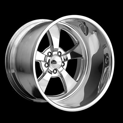

I must say I'm getting really excited to see it myself, I hate seeing all these sweet cars on here with nice wheels and then go to the garage only to find my rusty five spoke truck wheels LOL. Thanks USAwhoa...i like the wheels, i like the exhaust, and like the scoop. now lets see this bad boy come together!!!

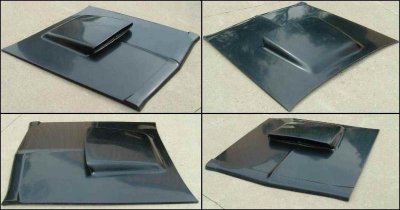

Thanks Speady, glad you like it (better replies than the Mach scoop got) haha. As for the wheel sizes.................I'm gonna copy you if you don't mind "your combo looks sweet". I remember you saying you were using spacers, what backspacing did you get P.S what width did you use for the front. I'm looking at 18"X9.5 with 5" backspacing and not sure on the front yet 17"X 7 or 8. Your compliments on the exhaust are much appreciated, quite a bit of work but am really happy with the look and sound "can't wait to post a video for you guys".Now we're talkin, I like that scoop! I say keep that angle/point to the nose as shallow (subtle) as possible while still being noticeable, since the point the hood is also pretty shallow. Maybe try and match the two as close as possible? But that looks awesome! I'm excited to see it jump off the paper and onto the car :icon_thumleft:
And those wheels look great! What sizes you going with?

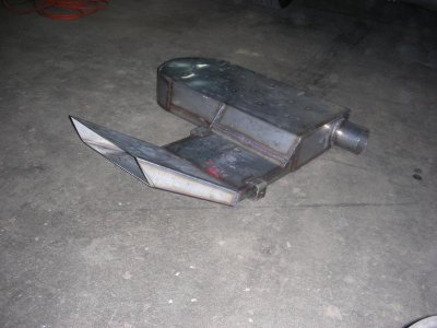

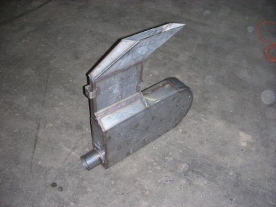

Damn to say that exhaust came out cool would be a huge understatement
Thanks BB61, soon my friend.Yea we need pics and video! Those mufflers turned out great.
Really, you wanted wider? I have 14" inside to outside (7"in 7" out) in my wells. The reason I say "really" is because a 9.5 is actually 10.5 overall making a 12" tire a nice fit with a little sidewall bulge where an 11" wheel would be 12" wide making the sidewalls flat. I want 12"s with an little clearance on each side. Yeah, by all means if you want to draw up a picture go for it "who knows it may end up on the car". My Rump Stripe decal was a picture I had drawn up for my helmet (used to race motorcross) that a friend took and completely redrew for me (never got it painted on a helmet but kept it all these years and now it just seems perfect for the car). Sorry, ignore the repeat scoop pic "windows 8 can be a pain".Yep definitely a more mopar looking scoop than the mach :icon_thumleft: if you don't mind maybe when I get back to the shop I'll do a little sketch of that scoop with a couple little tweaks?
And yeah no problem! Only thing I would've done different would be wider rears but 9.5" was the widest they had. But yeah if I remember correctly 5" backspace was supposed to be the way to go with the rears but don't trust me, take some measurements on your car first if you can. The fronts on mine are 17x8's with 4.5" backspace, fit like a glove

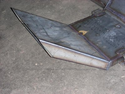

Thanks hunt, appreciate the encouragement. By the "if you must" I take it your not digging it, haha. I know what your thinking "why, when they have such a beautiful hood already" and your exactly right, I chickened out on it for that reason (loved the hood) but the guy who media blasted the underside completely destroyed it "I was literally sick to my stomach when I brought it home and had to have a few drinks to calm down". I always wanted a shaker and the hood wasn't salvageable (imagine every opening on the bottom, now imagine all of those spots warped severally on the top" as you can imagine very little original metal is left. I do believe that is the scoop I'm going with and won't be quite that pointy.Everything is looking great. I still can't believe you made your own mufflers - can't wait to hear them. Your wheel choice will look tough on the car. I think if you absolutely have to put a scoop on a Charger it should be something like cdr has, or close to it like your drawing with the "456" but with less of a point in front.
