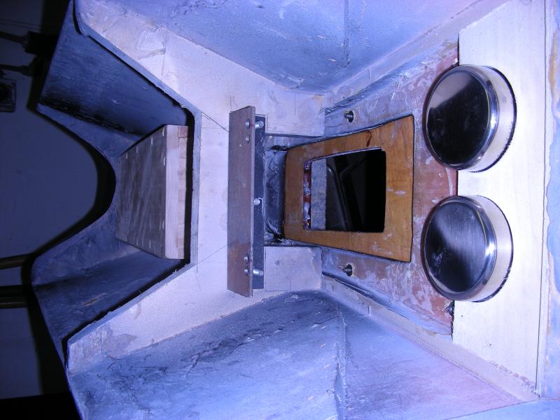

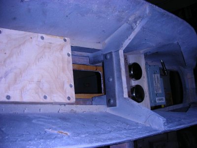

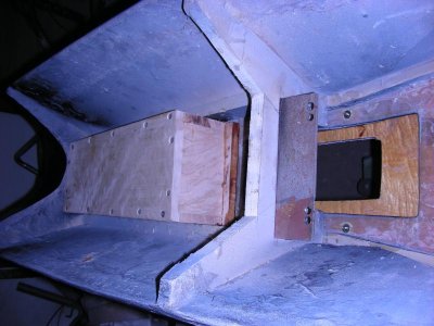

benno440, Love to see it when it's done, sounds great. I'm also going with thoses same size wheels. The center console was made first out of 1/4 luan plywood (it's somewhat flexible, cheap and can be bought just about anywere) and wood then fiberglassed over. I started off with cutting cardboard patterns until I liked the fit then transfered that to the plywood for the sides, I used 1/2" 5 ply plywood for the inner cross sections that tie the sides together and give it it's shape. There is also some wood used to connect the top to the sides and so on. It's best to temporarly screw it together until your happy with it then use a pneumatic stapler and plenty of wood glue for final assembly. Fiberglassing it is simple but miserable, paint one area at a time with the resign, lay your fiberglass cloth on and work out the air. I put 3 layers on mine knocked off the high spots and finished it off with a coat of filler. You can't really tell by the pictures but it goes all the way to the firewall and fits up to the dash and is still lighter than the original. I'll post some pics of the underside as soon as I can. Hope this helps

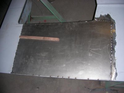

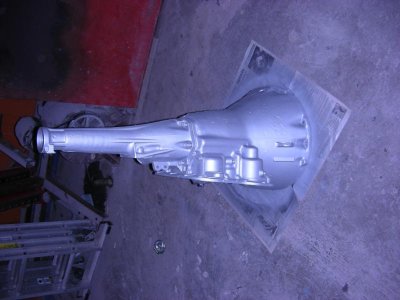

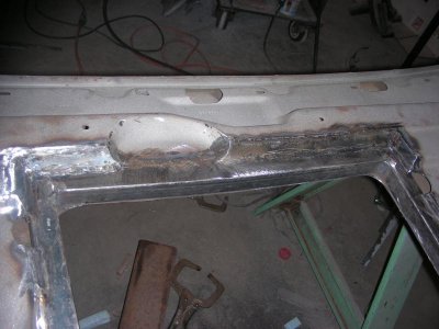

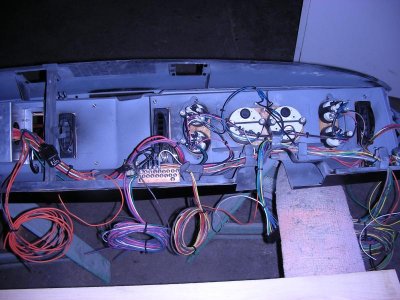

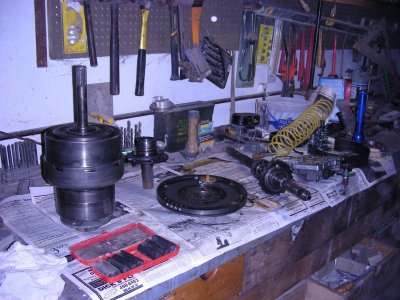

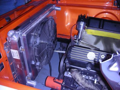

DSCN5600.jpg DSCN7487.jpgDSCN7483.jpgDSCN7481.jpgDSCN7480.jpgDSCN6262.jpgDSCN6259.jpgDSCN5609.jpgDSCN5608.jpgDSCN5601.jpgDSCN7491.jpgbenno440, here is some pics of the inside of the console. Something else I forgot to tell you is that you can use blue foam to make molds as well, I used it to shape the rear of the console (just make sure you paint it with latex paint if using polyester resign or it will melt). I thought I'd add a few more pics while I was at it, to bad I haven't been able to find my pics of the car when there wasn't anything but the rear frame rails on the rear of the car. As you can see I'm just about done wiring the dash, next step instal dash and fire it up. The trans is a 727 which I rebuilt using a hughes rebuild kit, tci bolt in sprag and a tci converter. The radiator is a BeCool, it and the fan are summit scatch & dent items. My car should be a driving scratch & dent advertisement for them, it sure is nice living close to a summit. I never filled you in on the motor, it's a 400 block, 440 crank, home ported 452's with 2.14 1.81 ferra valves, comp 21-224-4 cam, comp cam magnum rockers, performer rpm intake, keith black hyp pistons, 9.8:1 and a 870 vac sec holley. I'm hoping for a reliable 500 hp. And yes I had the heads flowed after I got done, they are real close to the stealth heads in flow.

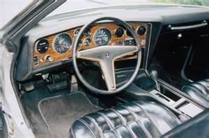

pont.jpgpont.jpgLooks like you are doing a nice job just not my taste.I always thought the should have off somekind of bulge or scooped hood on the 68-70 Charger.
Thanks, I know there are alot of people who like things the way they are supposed to be, I'm just not one of them. On the other hand, I'm leaving the majority of the car alone "why" because chargers are awsome cars just the way they are minus the ugly dinky wheels and the horrible looking dash. Sorry, I know somebody will not like that comment but seriously it looks like they couldn't figure out what to do so they just put padding everywhere. By the way that dash looks nothing like mine except it has wood on it. That's a nice looking gts.
Nice work. It will be sharp when finished. But it does look like a Pontiac Grand Prix. My uncle had a '69 with a 454 4-barrel. Was nice car..though....

It's pretty good stuff ! LOL.....seriously it's just the dash that reminds me of a Pontiac, I drove one in the late '70's, Grand Prix, model J, the rest screams Mopar.
