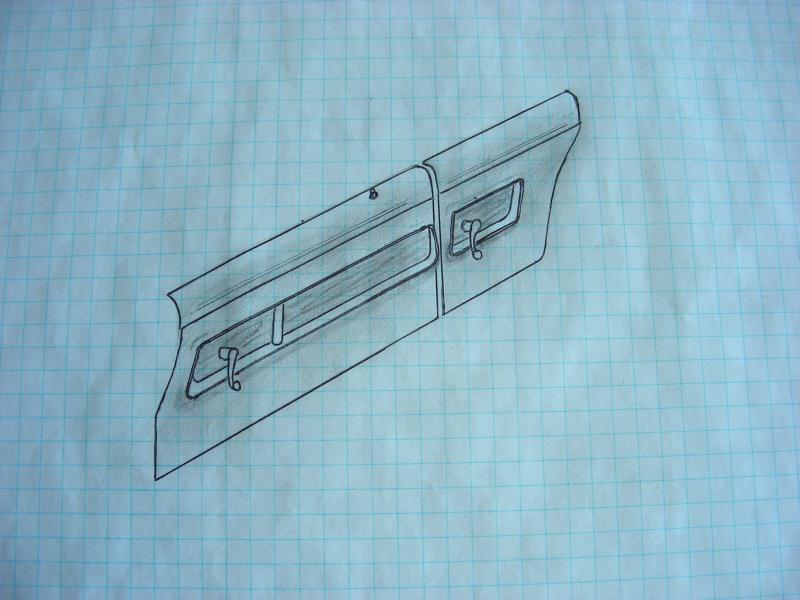

"Yeap" I'm hoping it will piss off allot of purist but for Tallhair's sake I'll emphasize "the purist who bash everything that is not pure, walk around with they're noses in the air while crunching VIN #'s and have no respect for others ideas" which most here are not. As for the panels I guess it depends on what you consider two piece, yes it will still use the padded upper panel (already wrapped in leather) along with the panel itself. Haha, we probably are a bit warmer than you, -9 this morning but at a whopping +30 right now "I think I'm going to take my shirt off, man does 30 feel good".
Here's the pics, the plan is for the center to be countersunk in with the back of the pocket being curly maple and trimmed from there out with stainless. I will ditch the panels I already made and start with 1/8 Luan using popular to create the contours leading into the pocket, first I'll bend up the pocket liners out of stainless seeing how it will be easier to shape the wood to match it then vise versa. The pocket liner will likely have a full back providing a place to secure it to the original door pull holes and giving something to fasten the wood to as well. I'm ditching all the fancy stitch work thinking just smooth leather would look better with this approach, he'll cover it into the pocket where the stainless will then cover it. I'll have to figure out how to cut matching splines in some homemade window cranks because of the needed depth because of the pocket (no power windows). I've got a cool idea for the door handle, I'm thinking since you will pull back while shutting the door that I can make it where you push the door pulls forward to open the doors. I've got plenty to keep me buisy for a while so it might be awhile before I get to it but I'm liking this idea.DSCN9022.jpg
I should mention Goon, my brother in law and Kahn were partially responsible for my decision to go for a more contoured panel. Thanks guys "more work". In case your wondering what I'm talking about Goon "check out your previous links panels".
HEY . . . How'd I get blamed for this ? ! ? ! ? ( SMILE ) . . . LMAO . . .
That's going to keep you busy . . . but man do I like the way that it looks ! ! ! ( dang - that man's a artist too ! ! ! )
