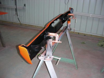

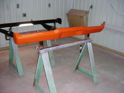

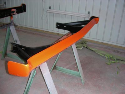

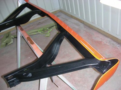

Here's the bumpers all done, I went ahead and spayed the insides with beadliner since you can't get in there to clean them. DSCN9056.jpgDSCN9057.jpgDSCN9058.jpgDSCN9059.jpg

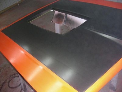

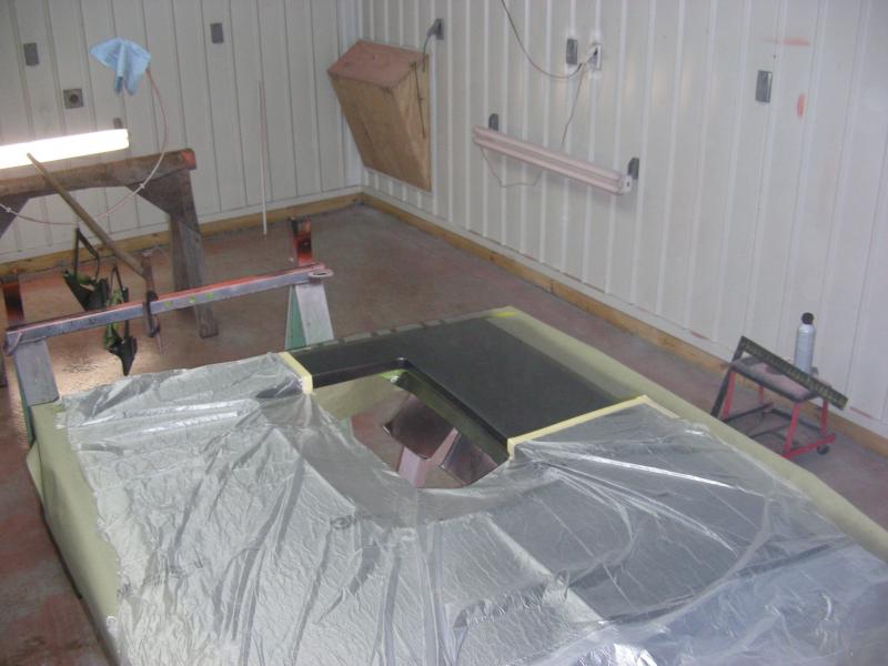

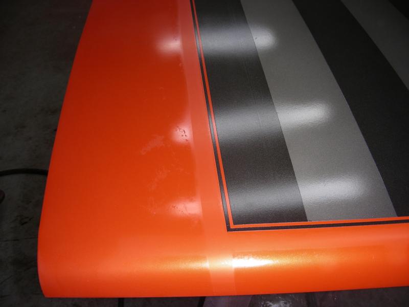

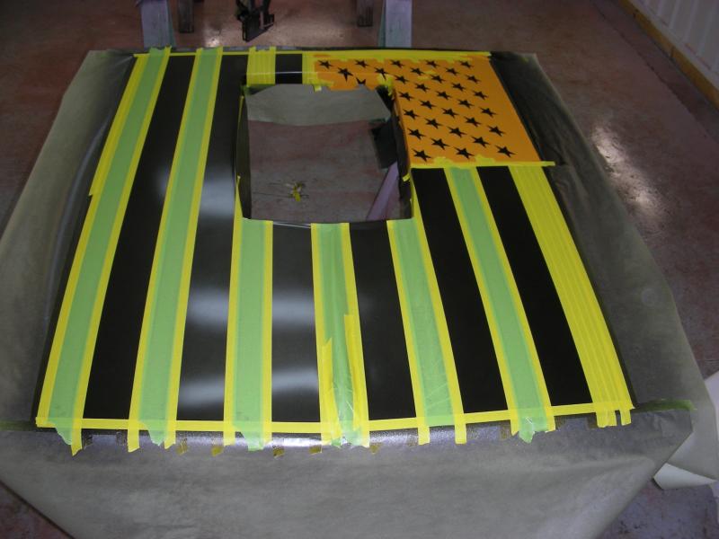

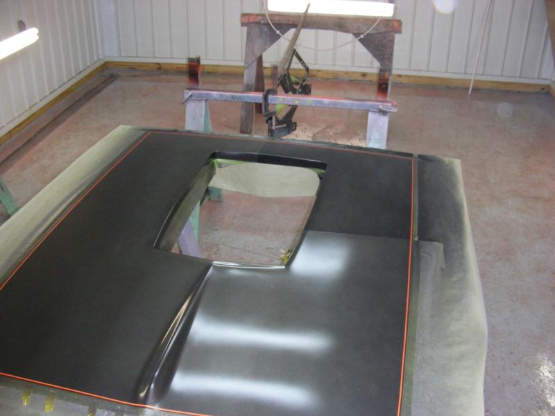

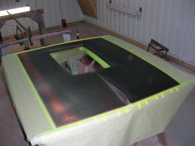

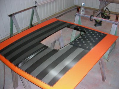

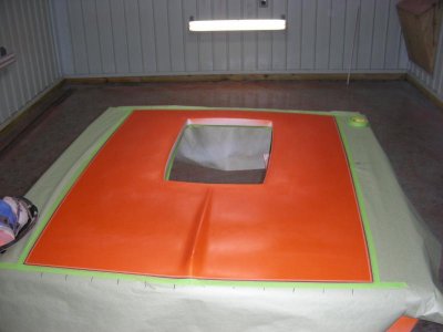

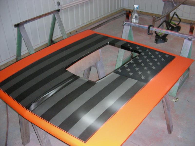

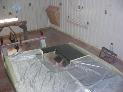

Here's the hood masked for the base (Galaxy Grey) and then painted. Second pic down is from last week, see the line just 3-4" in from the edge. I sanded it down and it didn't come back tonight. It went pretty well tonight except there was some tape marks left and it appears the chemicals are getting threw the masking paper (check out the last pic). Fortunately every time I got a good coat I topped it with a base clear so I can come back and wet sand before I clear coat it, it makes it nice.DSCN9054.jpgDSCN9055.jpg.

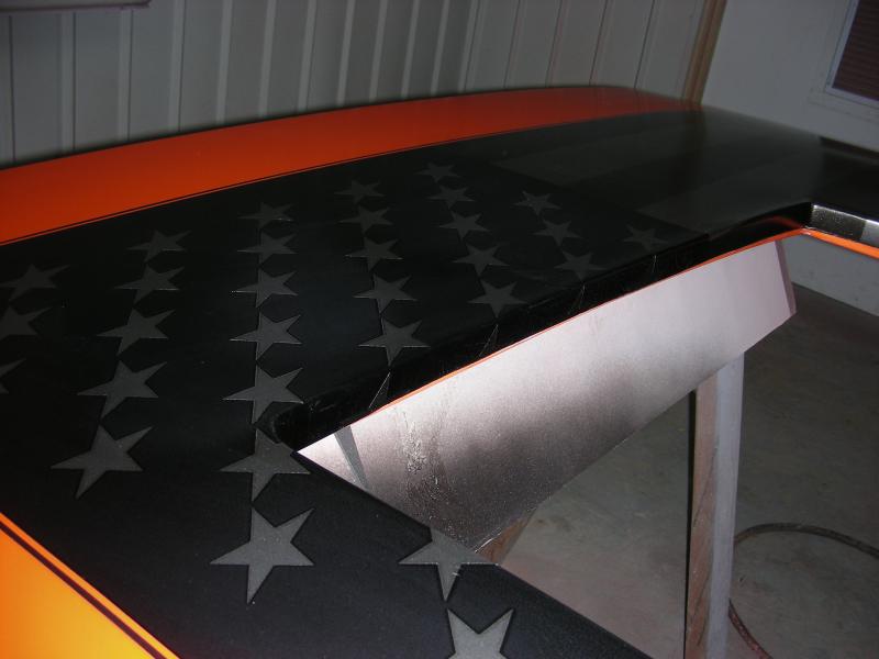

Thanks but the issue with it coming threw the paper has me a bit PO'd. If you look at the last pic, all of the orange had that matte look like it still has were the tape was but after pulling the paper you can clearly see were it has gotten it there and messed with the finish. Seeing how the next step was clear I had to bail (it would have showed up badly). If it doesn't sand out of the clear base I'll just mask the flag off with something different than that damn paper and shoot another coat of orange. Would have gotten more done but I took on more side work, a Nissan Xtera. What a pain in the a$$, it needed a radiator and valve cover gaskets which meant pulling the intake and it's fifty million hoses, wires, pipes, and whatever else was on it.:angryfire: I got it done, more money for the Charger.
Looking GOOD 747Mopar . . . I can see what you mean . . . very odd ? ? ? I've known body work people that used that tape/paper for year . . . wonder what caused it . . .
I know you'll come up with a plan to get it all squared away and looking fantastic ! ! ! Almost there ! ! !
As always really cool custom work! The tape setback really sucks as it seems all these bumps along the road must be having their toll (SOMETHING JUST GO RIGHT DAMMIT!!) but bare down and keep finessing your way through and you'll be on the road this spring
Man that sucks about the paper. I hope to are able to fix that General Grant hood. haha! The bumpers came out great though. Keep up the good work my friend, looks like you're getting to the home stretch.

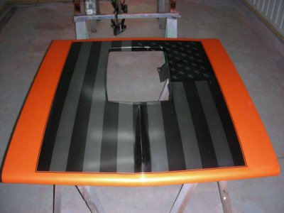

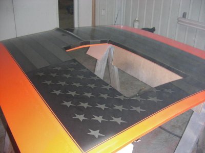

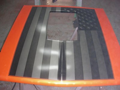

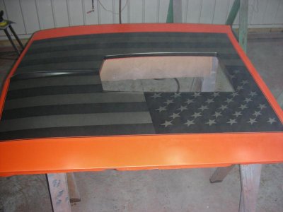

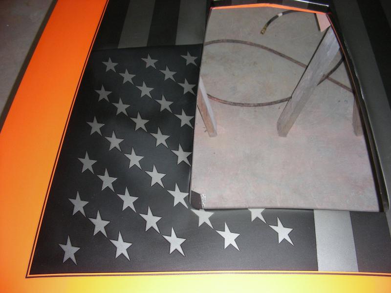

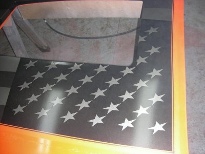

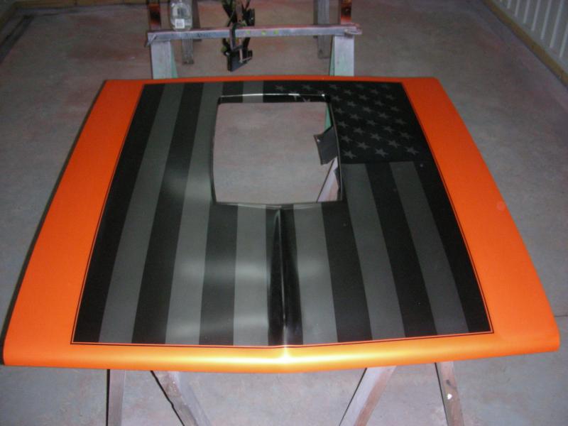

Got you guys some better pics since there was still a little haze floating around in the others, the goofy spots are all wet sanded out and looking good to go with the exception of one minor issue from pulling the masking off of a star which will be touched up no problem. I'm super excited about how clean the stars came out and that my custom mixed paint actually looks pretty good (they didn't have the shades I wanted so I bought silver and black to tint the Galaxy grey). DSCN9091.jpgDSCN9088.jpgDSCN9087.jpgDSCN9081.jpg

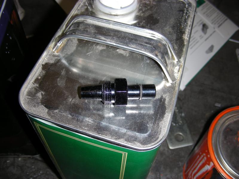

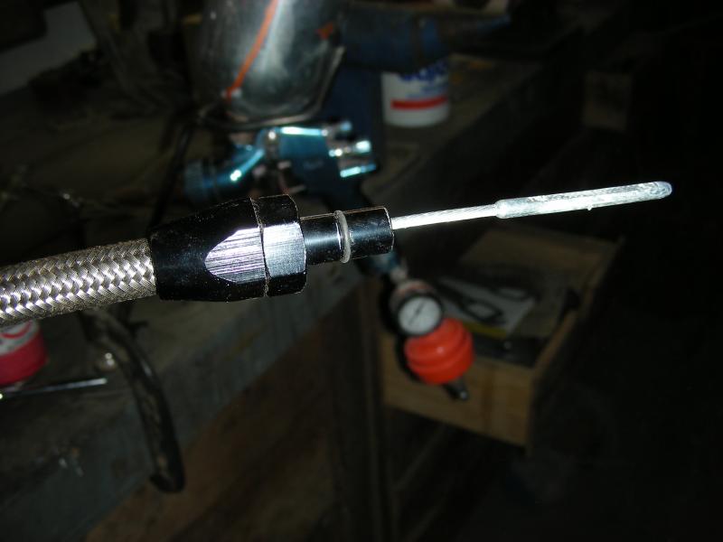

After some measuring it appears all I have to do to use the dipstick my pal sent is turn the end down about .020 on the lathe, put a thinner O-ring on it and change the hose length accordingly to get the oil level right "piece of cake right".DSCN9034.jpgDSCN9035.jpg

I'm pretty sure it's this potent House of Kolors reducer soaking threw that's causing the issues (it even started to shrink the star masking!). Yeap the paint side of it is almost done, just a few more touch up's and finish the buffing.
Damn everything looks awesome man! The hood looks like a ton of work but it came out bad@ss!!
If everything went perfect it would be about a 3 hr job but it never does, glad you like it.
OK, you just raised the level of awesomeness of your car with that hood.

After some measuring it appears all I have to do to use the dipstick my pal sent is turn the end down about .020 on the lathe, put a thinner O-ring on it and change the hose length accordingly to get the oil level right "piece of cake right".View attachment 175735View attachment 175736
