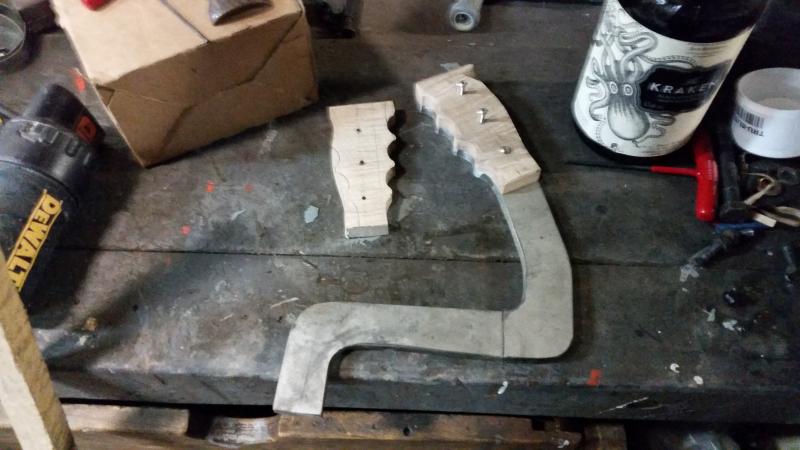

My dad's been pretty busy so he brought me 2 pieces of scrap Titanium home for me to play with so I milled this out, still need to weld the 2 pieces together but this is the roughed out handle and grips. Since I don't just have Titanium rod laying around I'll have him weld the top plate and bottoms for the handles on when he welds the 2 halves together. In the end you'll only see the handle and maybe an 1" of the lever because of the console and boot so not much polishing up to be done.

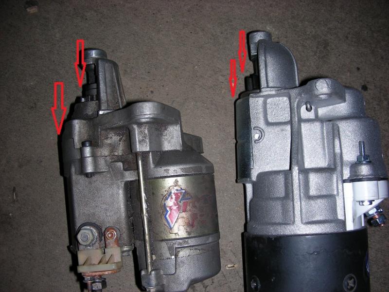

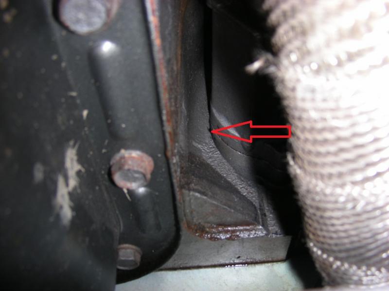

Last night I tackled the starter but am still not sure if there's even a problem other than what I found, the starter is up against the starter pocket in the block causing it to torque down a little crooked. For the most part it looks like it's mostly just some bad casting flash in that area so I had to use a long porting rotary file to knock it down but still needs some more work.

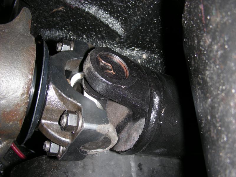

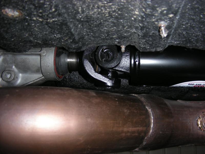

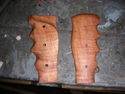

More progress, got the shaft and got it installed, hooked up the reverse lockout to the brake switch, figured out how to do the clutch pedal safety switch, made my Curly Maple pistol grips and got the passenger side fresh air vent taken care of (used a driver side vent to plug the hole since I'll be using Vintage air).

Here's the grips (still need to be cleared)
This is what I found on the starter, it's hitting the block causing it to bolt on a little crooked. A little rotary file took care of it although it still sounds a little different it seams to work perfect.

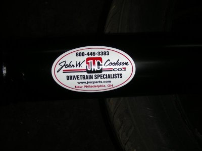

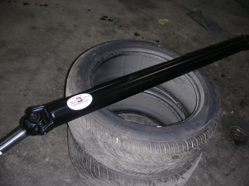

The new driveshaft.

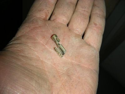

After trying to figure out how to get around slicing the wires for the brake switch to operate the reverse lockout I finally remember these things from the original harness and robbed a harness of one. Now I can just plug it in Voila!

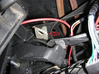

Sometimes you just have to step away for a minute, mounting a safety switch to the clutch is something I've been trying to figure out as to where to mount it and what kind of switch to use. Well I crawled back under the dash and Duhhh............ there was a perfect place (already drilled) to mount a factory brake switch above the clutch pedal stop. All I had to do was enlarge the holes to 1/4" and bolt an extra bracket I had laying around on and it was done (need to stop at the parts store and get another switch and it's done).

The new driveshaft.

New driveshaft looks like a really nice piece and those grips look better than anything you can buy off the shelf that's for sure! Can't wait to hear about the first drive with the 6 Speed now it's comin' on fast!

hey 747, what do you think of these for holding the driveshaft, i see you have the u-bolt design. just wondering if you heard anything on these. thanks.

Nope never saw those but the one I have looks pretty beefy already, you blowing yours out is what prompted me to upgrade to matching Spicer 199's (1350s) and the U-bolt style yoke so thanks for taking one for the team haha!

Thanks Goon, yes the driveshaft looks great and I'm very happy with the way the grips came out as well. I almost took it out today but when I got home my dad needed the running lights on his Jeep fixed so I didn't have time to mess with it. Soon very soon but the starter is still a possible problem.

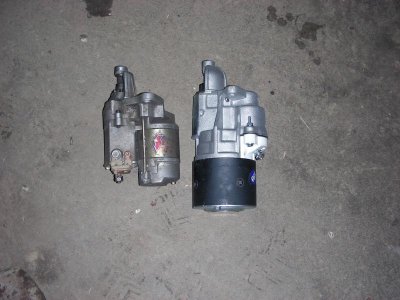

With an absolutely beautiful day I was hell bent on going for a cruise today for the first time, I finally got ahold of somebody at Quicktime that seamed to know something and was told I had to run an OEM starter Errh. I picked one up on the way home with the intention of getting it done in time for a ride "Yeah right". Changing the starter turned into unbolting the motor, pulling the plugs, jacking it up, removing the header and then the killer I found a broken header stud and what better place to find it but the very last one. With it buried under the break booster and close to the steering column it was bound to be a bare and I was already thinking about pulling the head.... A quick trip to a buddy's house landed me a sweet 90 degree Milwaukee drill, I had to cut my drill bits down to an 1" long and in no time I had antifreeze dumping on me (love it) and then got the bolt out. What a load of crap, after that I felt so fortunate to get it out I just called it quits.
In this pic you'll see why I need the OEM starter, the mini hits the block and you can see how much more meat there is on the mini where it faces the block. The only thing I can figure is they moved the starter down a fuzz meaning it also had to be moved in to keep the contact right and tightening the clearance to the block.

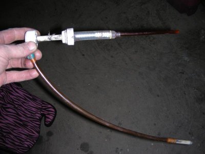

I bought this years ago for filling the outdrive of my boat with oil but it works great for filling standard tranny's.

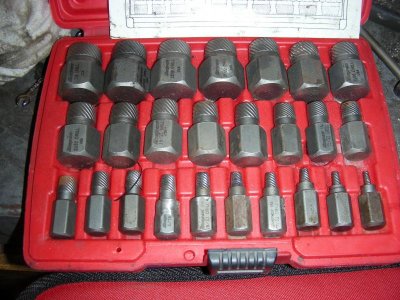

Today just sucked, I bought some more header wrap to touch up my pipes but after seeing the rust after just one year I chose to take it all off. I'll get them blasted and repainted but as you can imagine this meant pulling the other one and.........another broken stud. So I figured I'd make sure the starter sounded better and it sounded much better. Then I figure I better make sure the headers will fit around starter...... what a PITA but it fit after dropping the steering linkage and allot of cussing. Then I notice Half of a plug wire on the ground.. yeap I didn't get it out of the way and while cranking the motor over it got caught in the belt and ripped the wire in half (freakin great). I'm really getting sick of all the set backs especially after all of the hard work is done and went so well but I'm still pushing for the weekend. What really sucks is the wife's patience is growing thin with all of the "little" added expenditures that I always seem to find so I'll just throw an oddball wire on it and worry about it later.
