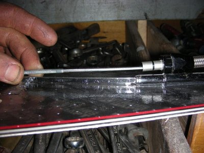

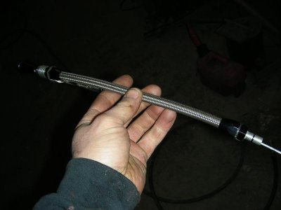

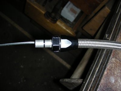

Here's the Lokar dipstick, it's for a 5.7 Hemi.
Had to turn the end down to fit the BB hole.

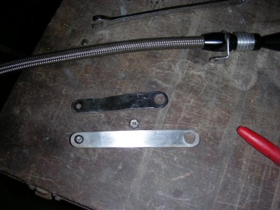

Also had the make a new bracket to mount it.
Then compare the length to get it set right which meant cutting 2" of the hose off.

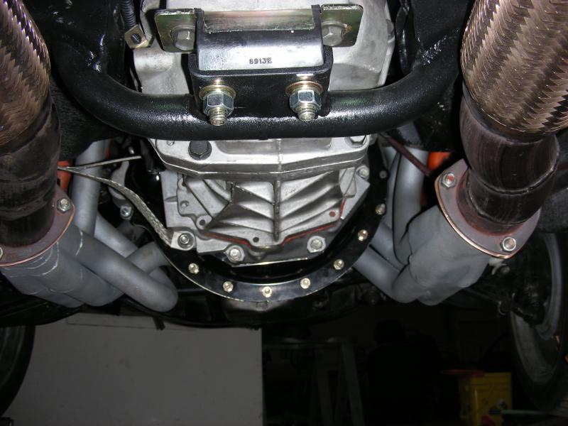

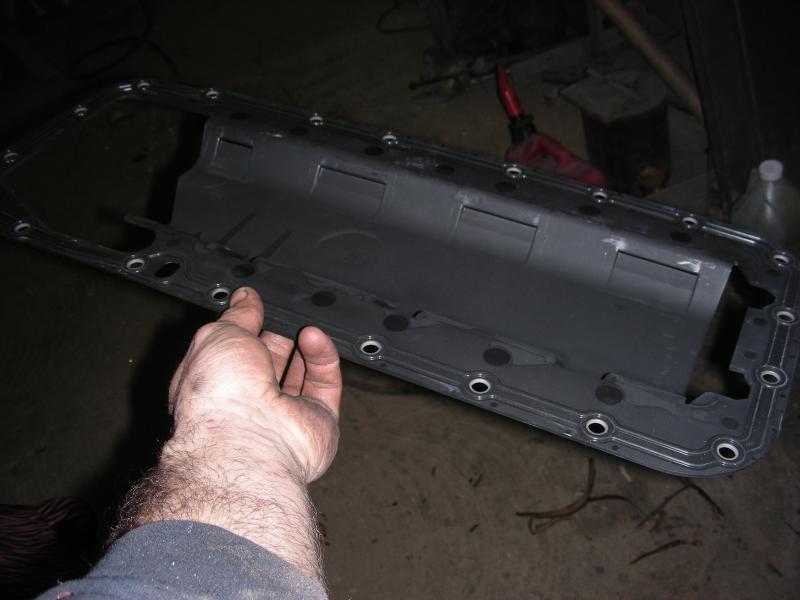

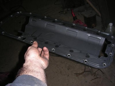

Here's my fix for the oil pan leak, pretty slick windage tray with reusable built in rubber seals (all one piece).

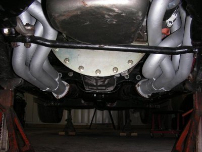

And a couple pics of the bottom of the car.
Lookin' cool as usual, great work on the safety switches. Gotta love that windage tray, what a brilliant idea with the built in rubber gaskets.

The under side of the car is as good looking as the top side! It all looks like it was meant to be there. As usual you do great work Devin. VIDEO, VIDEO, VIDEO!!!!!!! :)
