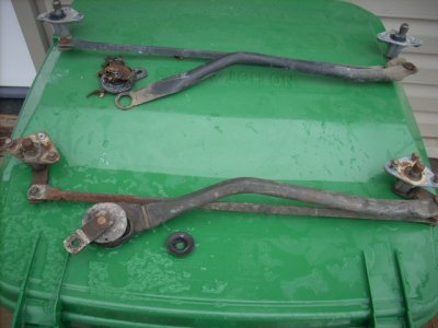

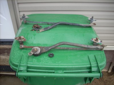

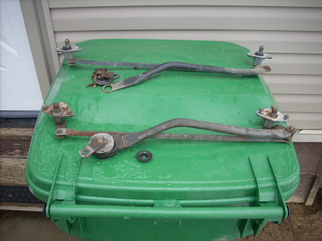

I just thought I would pass this on.I have 2 78 cordobas with non working 2speed wiper linkage.After some research I discovered 73-4 satellite and roadrunner and 75-6 cordoba 2speed linkage would interchange and eliminate the problematic later bushing.This linkage also elimiates the smaller plastic bushing and holds everything together with metal clips.Im have converted both of my cars and they work great.Here are some pics for comparison.The cordoba linkage is on the top.
Sorry the cordoba linkage is on top.
The bottom linkage looks to be the same as the top one. Have you a picture of the other side?
Hmmm, my 98% original 73 has plastic bushings.
What did the linkage with metal clips come out of?
I might be interested in that swap, as well.
Close ups of the bushings/clips would be nice...thanks.
