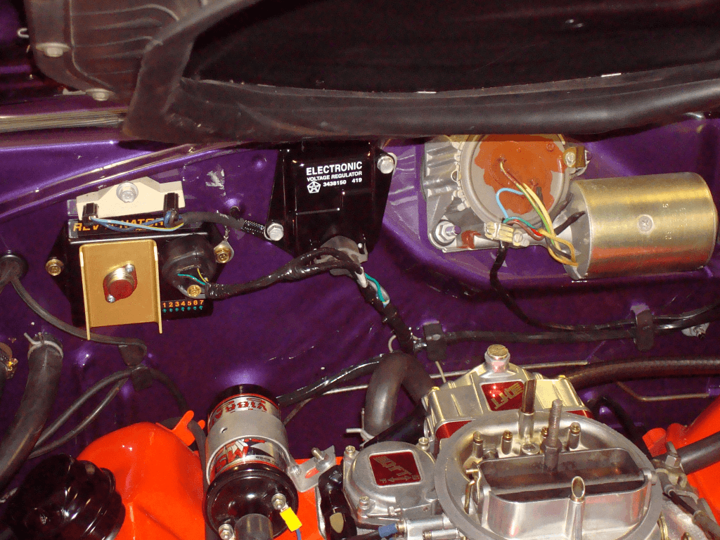

I also run one on my '70 GTX. Again, a very noticeable difference in performance over the Orange box ECU. :thumbsup:
Please remember that the Rev-N-Nator is not a cure-all....you need to get everything else correct as well - same for any Ignition swap over.
