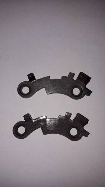

If the Bee was a console shifter, i would do the RMVB in a second. I much prefer a manual car, but the column shifter is kind of a PIA. The column was just rebuilt, but the shifts between gears is kind of sloppy, not crisp like I think it should be. And then there's few Mopar peeps around me with column shifters to compare with.
I find it comical folks don’t want to shift all the time with a manual valve body and then later install a manual trans, or build a manual trans car.
.......the shifts between gears is kind of sloppy, not crisp like I think it should be.
Are you talking about the column lever being sloppy/not crisp, or the transmission shift. They are unrelated.

But it's the column lever that is sloppy. When the column was rebuilt, the rebuilder had a slightly better "notched plate" that he swapped in for me, but still not crisp. Here's a picture, and I'm hoping he swapped in the top piece for my bottom piece.
Certainly some inherent sloppiness between the column shift arm to the transmission.
