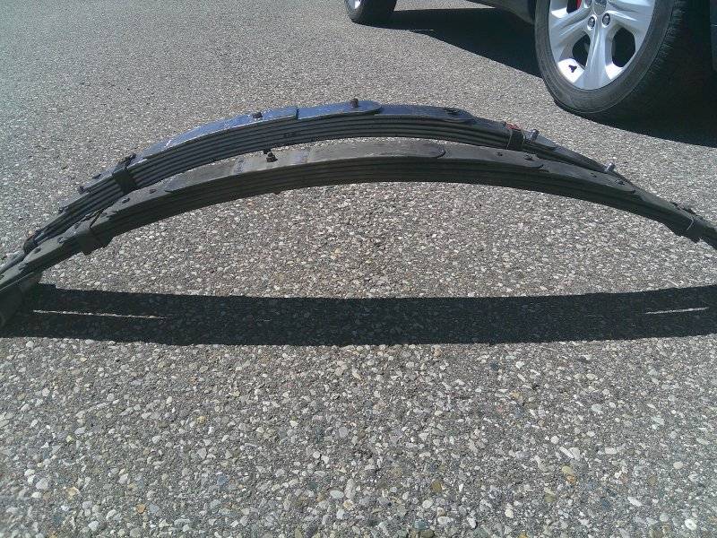

If it is any consolation, the right side spring will sag first, and will level out. If you look at spring leaf stack, the second leaf on the passenger side stops well short of the rear shackle eye, and will sag in this area. Looking at the left side spring, the second leaf extends almost back to the rear eye, resisting this sagging. I run two left side S/S springs in my cars. This will delay sagging, and your car will sit level. Over the past 25 years, my S/S springs gradually sagged, and I had them rebuilt with more arch, and had the second leaf replaced with a new one that stretched from the front spring eye to the rear one, to support the main leaf. With the extra 2" of arch, I was able to mount the front of the springs in the upper hole of the hangers to get the ride height I wanted. I figure if the springs sag again, I can lower the fronts down to the lower hole, to pick the car up again. Remember that S/S springs were never engineered for everyday use in a street car. The springs were staggered to make a race car launch a certain way.

Think the problem here is just like JCC62 said and I am dealing with different leaf springs.
