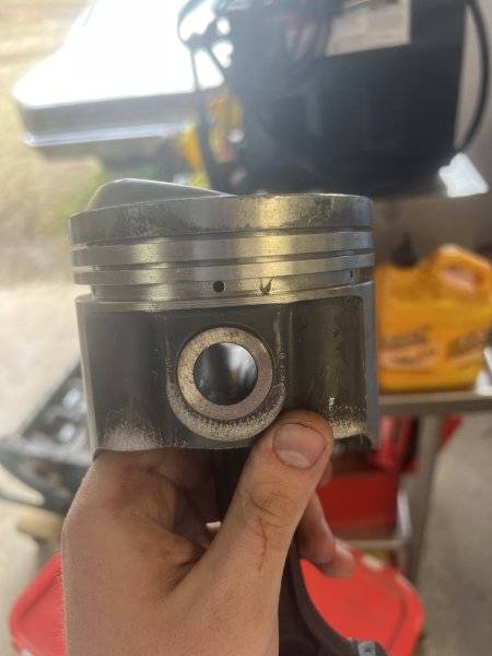

I’m partway through building the bottom end of my 383. I was just about to gap the piston rings but when I test fit them they won’t go in the grooves on the pistons…
Do I need special rings or something? 30 over TRW L2293 dome pistons and Hastings 30 over moly rings.

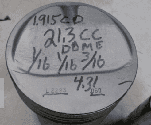

TRW piston aren't factory pistons, my TRW's 1/16, 1/16 and 3/16 think that is what TRW's use.
Here is a piston from ebay. Looks like it has a 1/16,1/16,3/16 ring pack. Looked your Hastings rings up on summit and they are 5/64, 5/64, 3/16

Late to the party. TRW dome pistons are 1/16.
