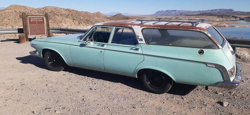

My '63 Dodge wagon has, what I believe is rear axle bearing roar, when side loaded. It's quite when driving in a straight line, but any deviation, such as a lane change, or bend in the road, creates the roar. It is the same sound level, regardless of speed, or amount of side load.
It's a tapered axle 8 3/4 rearend. Fluid level is correct.
I am thinking, it's worn axle bearings. Am I on track, or way off base?
