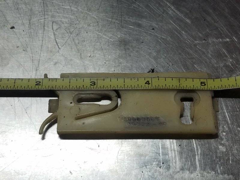

The last body shop siliconed the rocker trim that runs from wheel to wheel below the door. I removed one that is coming apart and found little nipples that looks like they are for clips. Where do I find these clips? Anyone have a picture of what they are suppose to look like? I can match them up. Thanks.

Yes, the little nipples hold on the trim clips. Check RT Speciatlies
Good luck with that.

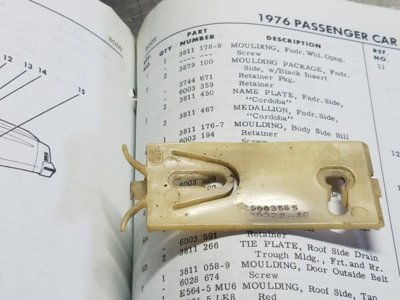

The Mopar PN in 75 & 76 is listed as 6003194, the 3 spares I have stashed have PN 6003565 molded in to them. It might be worth a laugh to run those numbers past the parts counter at the local stealership just to find a later supersede.

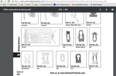

Speaking of Dorman, their most current on line body parts catalog is dated 2006 and shows something that looks damn close. The PN is long since disco'd so pretty much a dead end too.
No way to say what it originally replaced - could be the wider lower moldings on 78/79 or lower side moldings on pick ups with the SE trim package. That's the major problem with replacing these clips - they were produced in 100,000 variations.

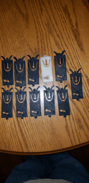

Hey, I could really use some of those...how much would you want to print a few for me?
I haven't installed them yet but should be soon. Body work almost done. I'll keep you informed if they work or if I need to get them modified.
Sad to hear they didn't work. This thread seems to have established that these clips simply do not exist. The only option I can think of is 3M double sided tape...they use that stuff on modern cars to glue body panels together...I used it to add ground effects to my '13 charger...pretty good stuff....maybe it will work just as well with these parts?

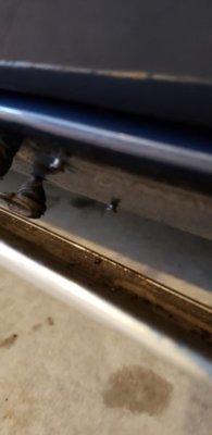

You shouldn't have to drill any holes in your rockers...if your vehicle came from the factory with the trim, the rockers will have small "teets" that the clips latch on to. No holes or drilling. Check out the pics at the start of this thread
