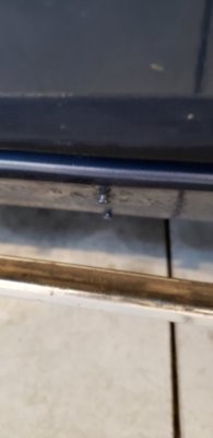

The last body shop siliconed the rocker trim that runs from wheel to wheel below the door. I removed one that is coming apart and found little nipples that looks like they are for clips. Where do I find these clips? Anyone have a picture of what they are suppose to look like? I can match them up. Thanks.

Good luck with that.
The Mopar PN in 75 & 76 is listed as 6003194, the 3 spares I have stashed have PN 6003565 molded in to them. It might be worth a laugh to run those numbers past the parts counter at the local stealership just to find a later supersede.
One possible after market replacement, PN CP774457 is on pg F-053 of this catalog:
http://www.dealpro.com/images/Fsection.pdf
note that the publish date is 1999.
The biggest supplier for this kinda stuff in the 70s was a company call Auveco but their on line catalogs don't go back that far. I think the path of least resistance is going to be a generic spring clip (Dorman):
http://www.autofastco.net/universal_mldg_fasteners.html
If ya click the Dodge / Chrysler link on that page, you can see that this place caries clips using the DPI part number format, but not this clip.

You shouldn't have to drill any holes in your rockers...if your vehicle came from the factory with the trim, the rockers will have small "teets" that the clips latch on to. No holes or drilling. Check out the pics at the start of this thread
