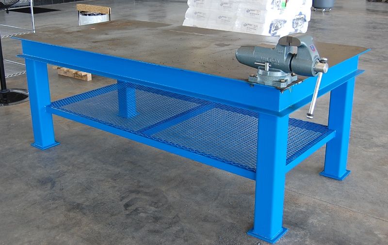

Well, I've changed my mind and decided to build a nice free standing bench instead of a cart. So now decisions, decisions. Metal or wood, casters or not, what type of material for the top? I want something stout that will take some weight. Thinking 4 x 6 or 4 x 8 and I will probably put a vice on one corner.

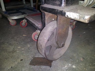

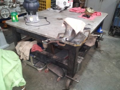

Here you go H2E . . . here's an example of a mobile bench. As I said, it's VERY stout . . .
The whole bench is really about 4 X 6
You can see that the casters are also very stout

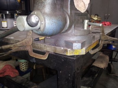

And he's got a bench vise attached ( I've use it and it works great ) - but look at the table top - THICK aluminum
He's using this mobile bench all the time - I'd love to have something similar to this . . . Hope this helps . . .
That does look pretty cool. I don't think I would want to know what that chunk of aluminum would cost though. What's the deal with holding the vise down with clamps? Oh yeah, they call those vise grips lol. Maybe you could buy him some bolts for X-mas.
Now that's funny H2E . . . LMAO . . . "Vise Grips" . . . Not sure why he has it calmed and not bolted down ( I may just have to ask now ) . . .

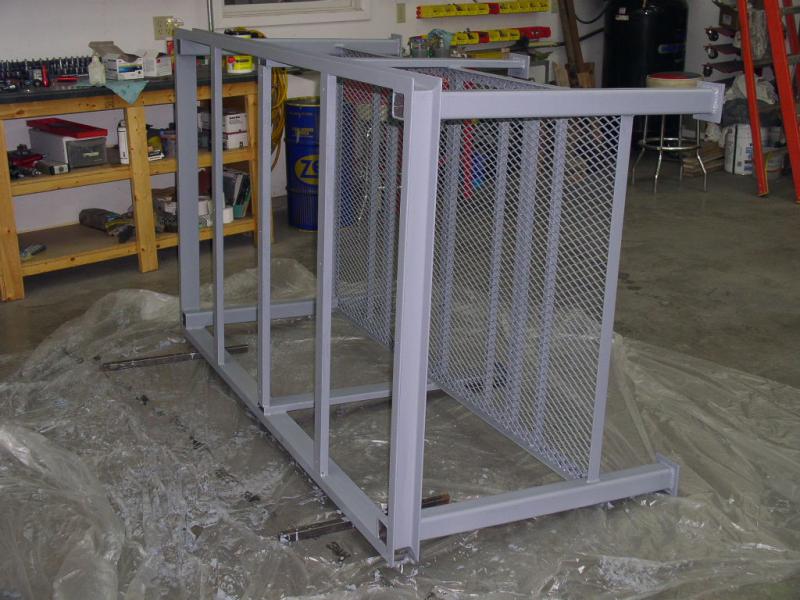

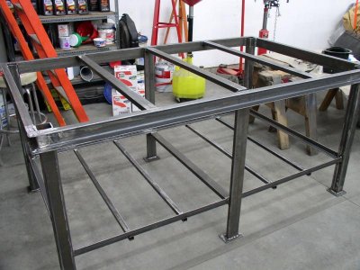

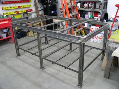

Thought I would post a couple of pics of what route I ended up going with. Got this much done this weekend. I changed my mind slightly about wanting a cart, and went with a bench instead. I have been accused of going a little overboard at times, and I guess this would be an example of that lol. I'm fairly certain this thing would hold up a car with no problems. The top will be 4' x 6'8". I am putting expanded metal for the bottom shelf. I traded my Millermatic 140 for a Lincoln 180 dual recently and have to say that I just love it. This is the first time using it and I am glad I made the trade. Sure will be nice to get rid of the makeshift sawhorse table.
Got the rest of the metal welded on and started to paint it. I ordered a 7 gauge piece of metal for the top that will have all 4 sides bent down with 90* flanges.
:headbang:show off looks great that's a nice cart when you going into production
Nice! If bad weather would ever hit your area you can hide under it too.
