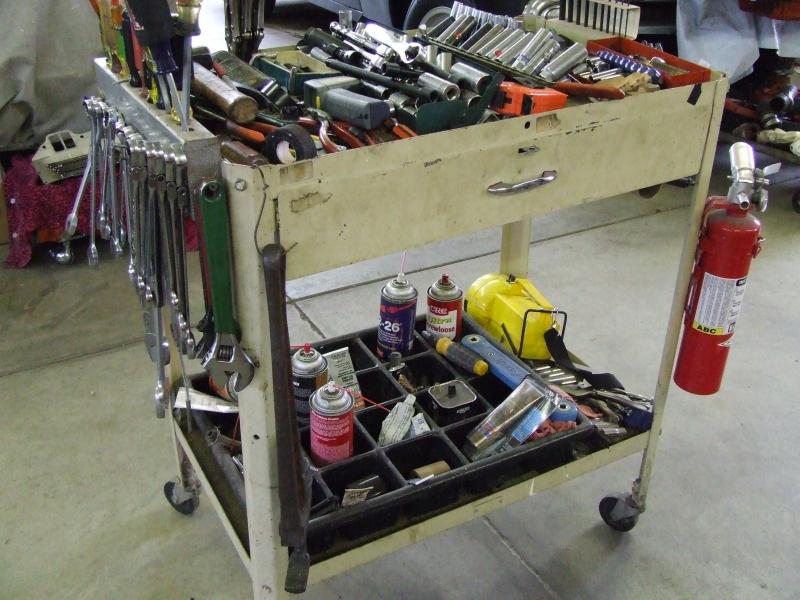

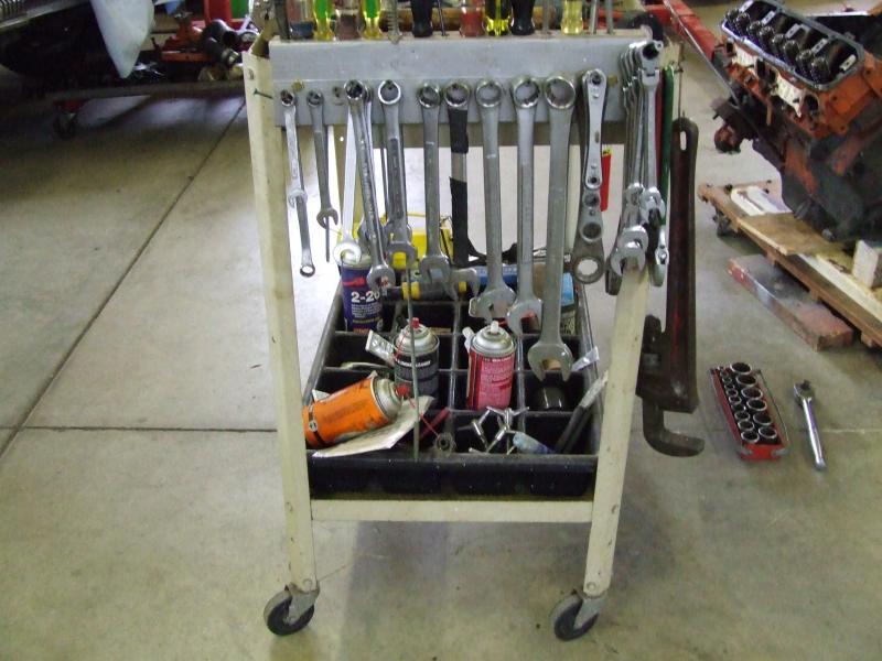

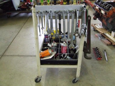

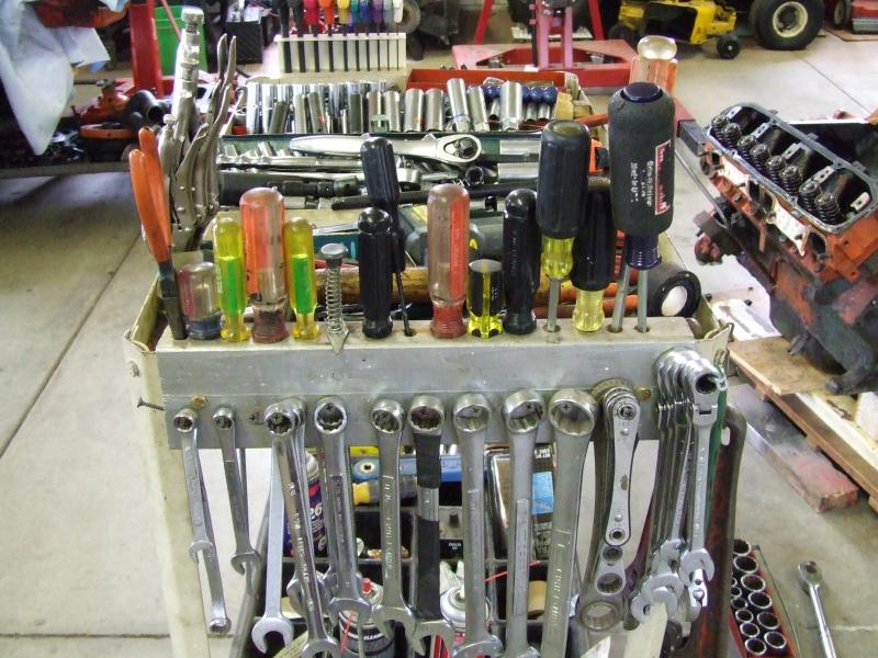

I new a guy that bought a crash cart from a hospital and was able to use that. It's a cart they used to keep stuff in they needed when someone was having the gripper. My cart is about 24"x30" and has 2 shelves. On the top I keep all the tools I use the most because I hate digging through a tool box no matter how well it is organized. I hang my box end wrenches off the side and attached a 2X4 on the side, drilled about a dozen holes and keep my screwdrivers in there. I don't have to lock up my tools so security is not an issue. I love my tool cart!

Here are some pics
I figured if I put the fire extinguisher on the cart I wouldn't need to use it and so far that has been the case. Kinda like washing your car and it rains the next day but just the opposite scenario.

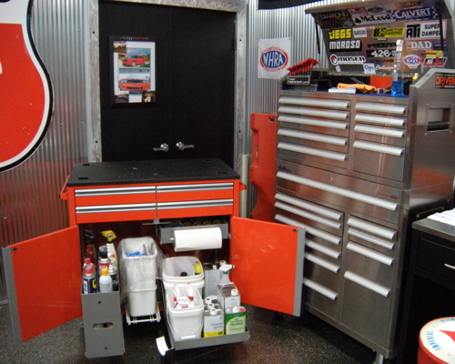

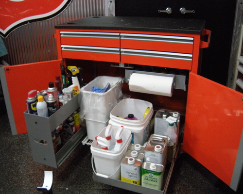

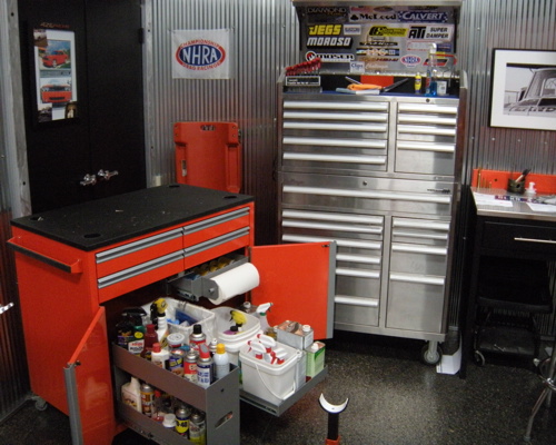

Here's my "team". What I've discovered over the years is; if I try to load too much into one space; I lose $hit. So; here's the set-up. Lowes Kobalt chest (floor model, scratched, dented 1/2 off) and a Challenger Cabinet (crash cart). I have used this piece for everything. Portability is the key. I'm never more than 2 steps away from tools or a place to put parts. Clearly you can make the cart, enclosed or not, IMHO use it as an accessory, a supplement or support piece. As mentioned before, if you build your own, DO NOT skimp on the casters!! Make sure you post the end product.

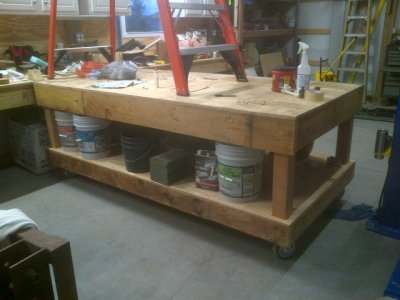

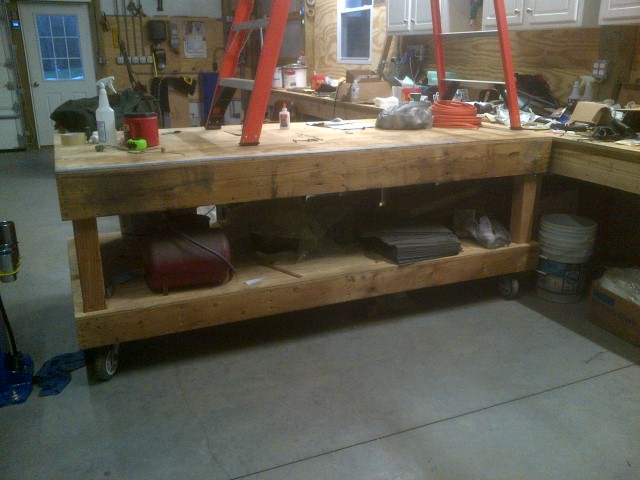

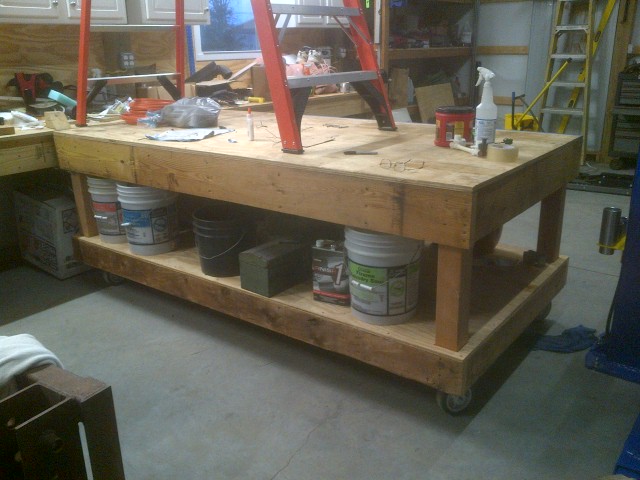

Here's my mobile workbench. Right now i'm using it to set my ladder on to get into the attic. It has hooks that attach to the main workbench so it won't roll away while i'm on it. One concern is that it could roll into a car. I need to add two locking casters. It's built on 16" centers just like home construction. The top is 3/4" plywood, the second shelf is 1/2". I suspect i could lower a car down on it and roll it around.
Here's another. The casters came from Tractor Supply and are rated for 750lbs each or something like that.
