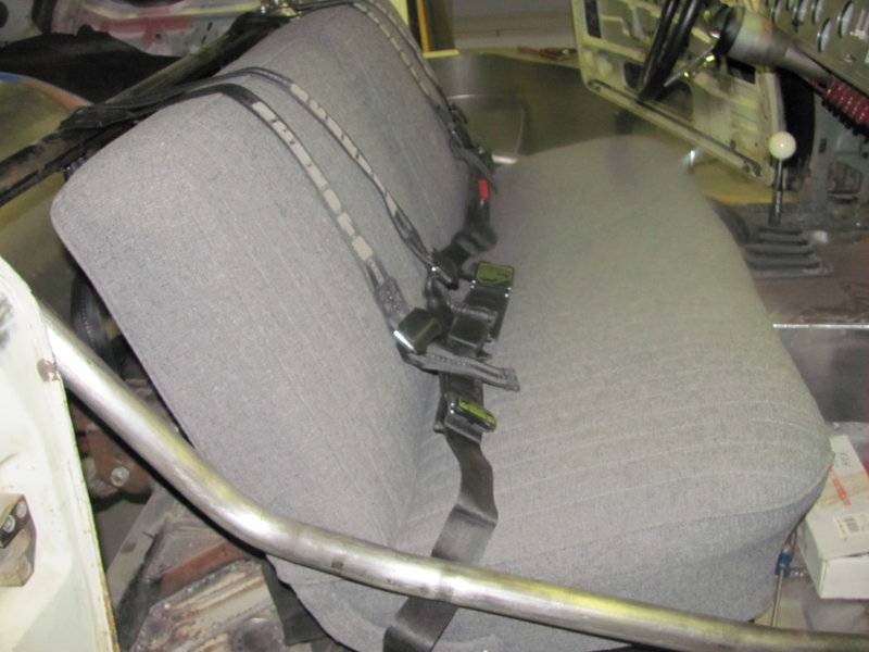

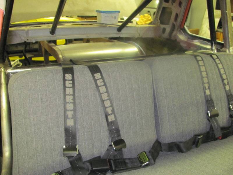

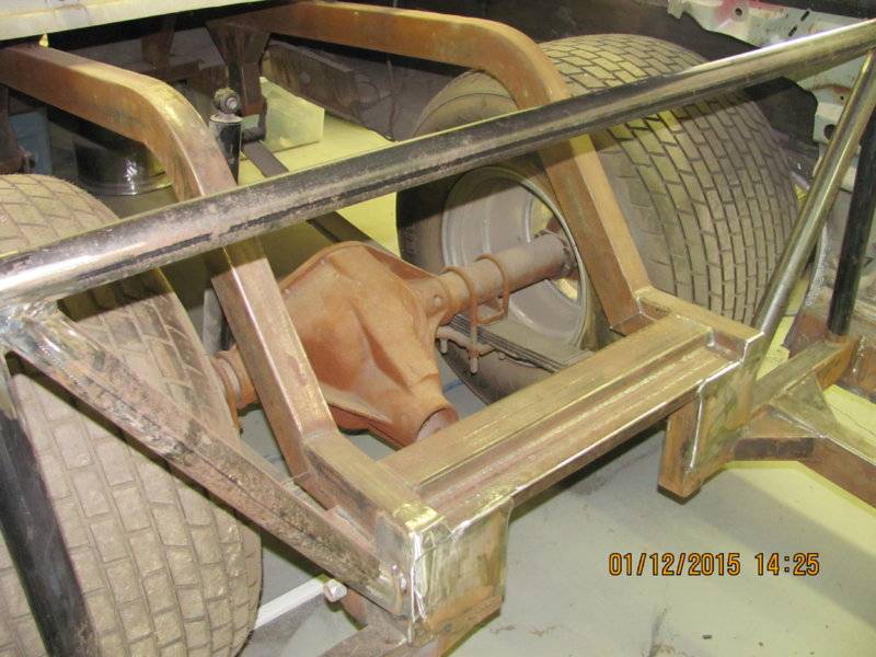

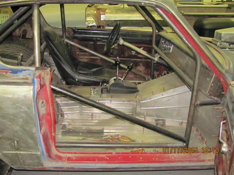

I have build several cars for my self but do not think of my self as expert in the matter . I know me and I will play with my toys and play hard so I put in cages and roll bars to keep me and my passengers safe . I have several pic's of cages in my projects that I am working now . One has a roll cage and ties to the frame and the other is a roll bar with the side bars bent down and out to ease the pain of getting in and out , this one is also tied into the rear frame rails . The choice is yours . Hope this helps . Thanks John Also seat belts with shoulder straps help keep you safe . P.S. the last shot of the Yellow Willys is a car that it built 30 years ago it did not have a cage in it and was a fiberglass car and yes I did play with others some . Just lucky I guess . All this is food for thought !
