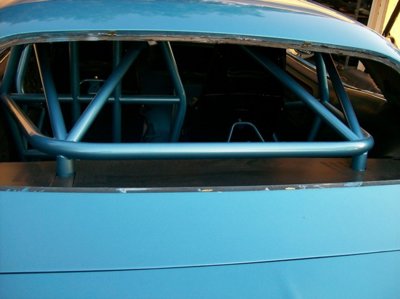

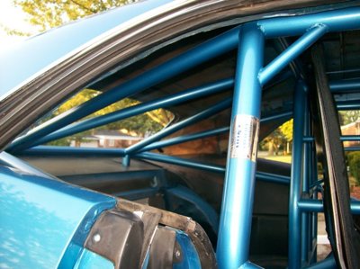

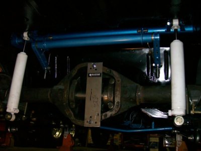

We custom bent every bar in my car. Mine go thru my package tray into a tubular upper shock mount we made to incorporate the anti-roll bar as well. One of these angle tools are very helpful when figuring angles also.
