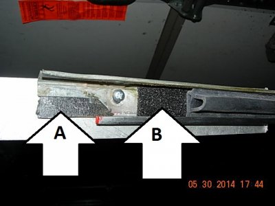

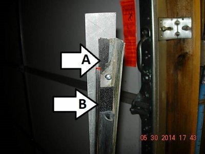

In these pictures, the piece of aluminum simulates the car roof. Letters show the piece of foam described in this example.
(A) The first one is a 1/8" x 7/8" single sided adhesive dark gray foam tape that is applied to the back of the stainless drip rail. The stainless drip rail is then screwed to the roof. This foam tape seals the drip rail to the roof.
(B) The second one is a 1/8" x 7/8" black poly foam strips seal between the galvanized weatherstrip channel (that the door window weatherstrip snaps into) and the stainless drip rail. Use some yellow or black 3M weatherstrip adhesive to hold the strip to the back of the weatherstrip channel during assembly should be all that's required.
Then use black 3M weatherstrip adhesive to attach the drip rail weatherstrip to the galvanized weatherstrip channel and wait until dry.
Hope this helps someone who did not know about the method of installing the drip rail galvanized weatherstrip channel.
BTW, I purchased the tape and foam strips from ebay. The parts are from Detroit Muscle Technologies.
