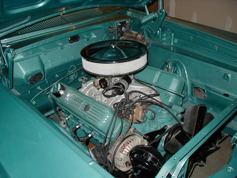

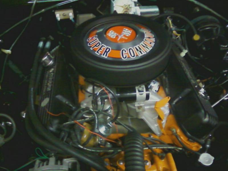

I used a Edlebrock rpm intake and holley on my 440 in my 66 belvedere and clearance in very close. I had to use a shorter air filter which lowered the breather lid but it does fit with no problems. A drop base would cause other clearances issues like the location of the coil. I didn't need a drop base.

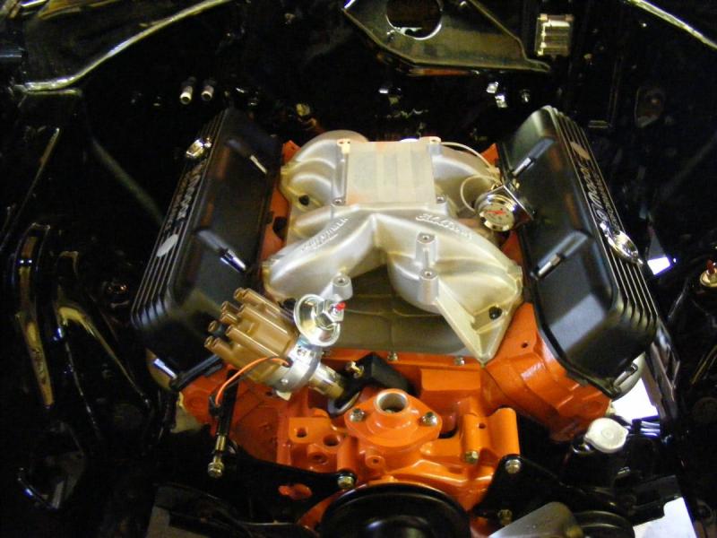

My buddy ran a Holley street dominator intake on his '69 roadrunner, Holley 750 DP, Fit fine.
This is a Holly Steet Dominator intake with a Carter 750.

Not to change subjects, but all those are awesome engine shots!!!
