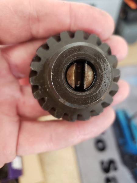

Could this be the problem? The slot in the oil pump drive shaft is not right. I pulled the shaft out, it has a nice snug fit between the cam gear and shaft gear. The slot in the shaft is worn on the ends and not clean cut.
This is a pic of the slot in the oil pump shaft from this 318. The slot looks wallered out.

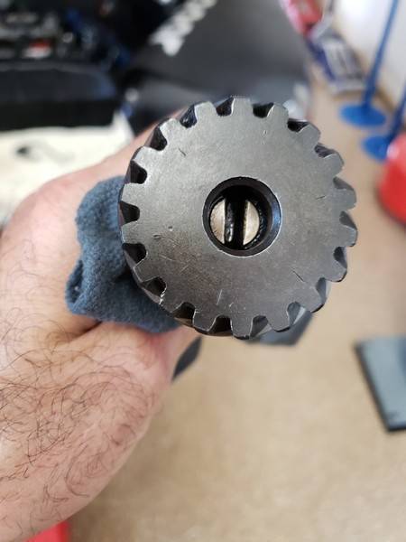

This is a pic of a 440 shaft I have. The slot is uniform.
