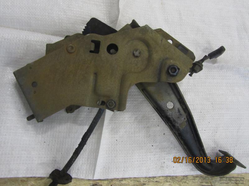

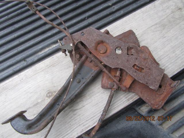

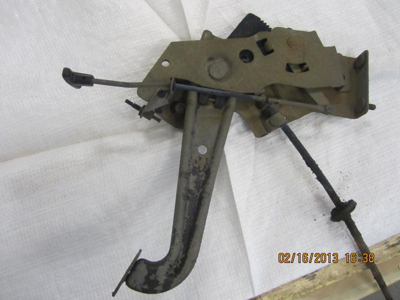

Wow, all these great ideas! Anyone try any of these on bulkhead connectors?
Here you go Tallhair. It was all siezed up before but now its loose. I left it in too long and it disolved the spring on the release. The first time i took it out the paint was all intact too.
