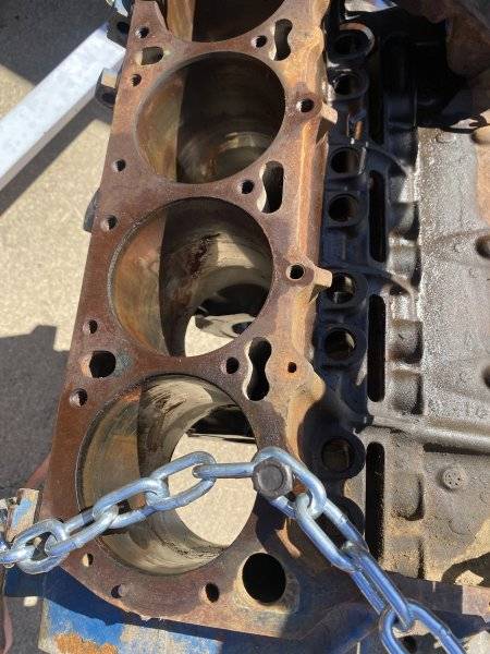

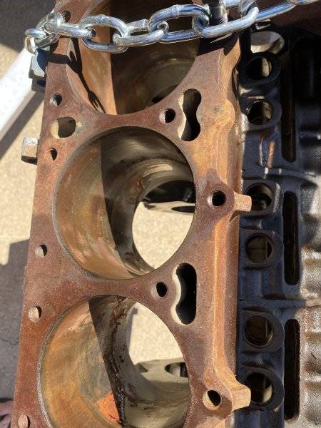

So, despite being told my block would be good 0.030 over and using a 0.035 over piston, apparently there is still a ring ridge of 6 thousandths. My rotating assembly is all balanced, so at this point it’s almost cheaper to buy another block and pay to have it checked out and bored.

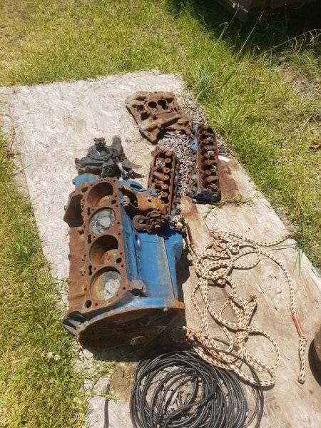

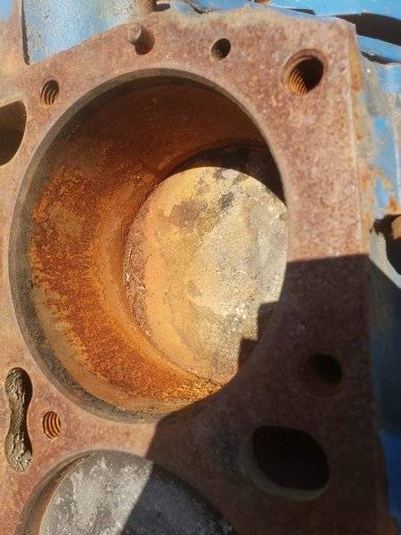

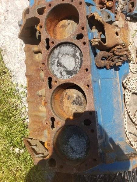

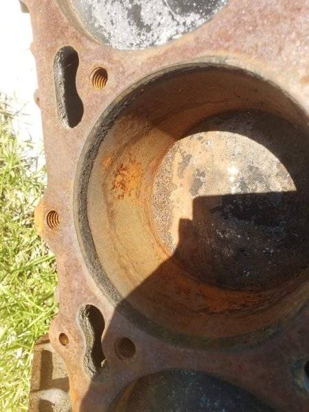

There are only a couple 400s close by. This one was sired behind a shop and has some surface rust but is supposedly standard bore. Is this rust that you guys think would likely clear up with .035 overbore or would it need more? I’m almost more worried about the rust than ring ridge. It seems like it should, but I have little experience dealing with rusty cylinders.
It’s about an hour away. I can get the long block for $200.
Worth the gamble?
Hard to tell from a pic, but I think I would pass. Remember .030 over bore only will remove .015 from the cylinder wall at the most. First pic looks like rust pits but again can't tell for sure.
I would sell the pistons you have. Get the block you have bored as little as possible to clean it up, and get the right pistons for your bore. If you buy the same brand/type of piston it shouldn't take much if anything to balance it.

As long as there aren't any deep pits, it would probably clean up at .035 if it is just surface rust. I have a 400 Pontiac block that was stored outdoors since the early 80's. It was solid rust. The block was original to one of my GTO's so I wanted to try to save the block. It was already .030 and it ended up being saved at .040.

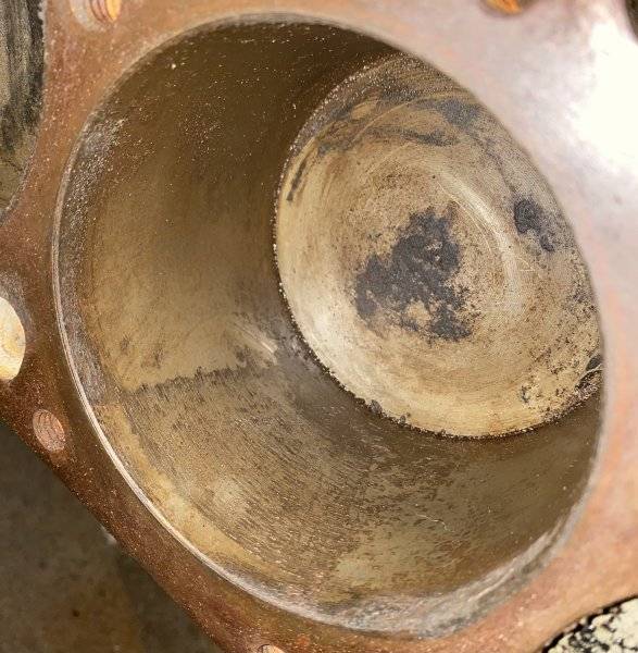

Ok, you need to understand what you are attempting to say because your statement is incorrect. The "Ring Ridge" is the unworn portion of the cylinder at the top (yes, I know you know this). But, after the cylinder is bored to 0.030" to be honed for a 0.035" piston, there is NOT a 0.006" ring ridge. The ring ridge is the exact diameter as the rest of the bore because it has been bored to 0.030" oversize. The problem is that the 0.030" bore did not completely clean up the top of the cylinder, and has left what I call an "Eyebrow". It is a divot and quite actually won't impinge on the piston or rings. The proper thing to do is have the cylinders bored another 0.010" for a 0.045" piston, and that will clean up the bores. As far as the balance goes, take an old piston and the new pistons to the machine shop, and have the new ones "Match Weighed" to the old piston. This way, you do not need to rebalance the entire rotating assy, just the new pistons.

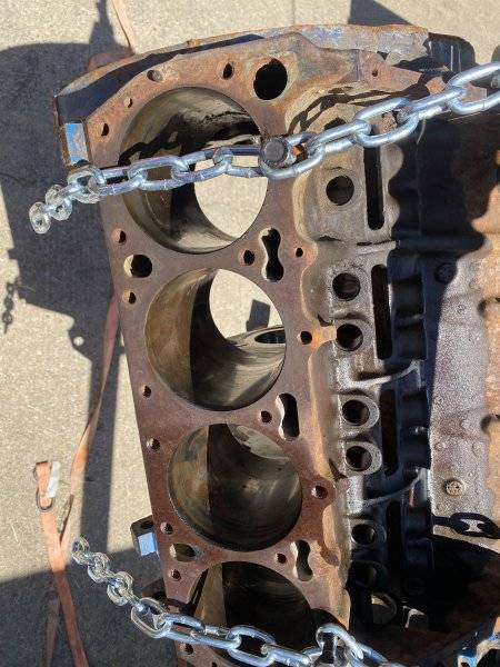

This is the worst cylinder on the second block. For those with experience in this sort of thing, does that look 0.030 over, 0.060 over?
Check the weight of both sets of pistons, may be the same, no need for re-balancing.

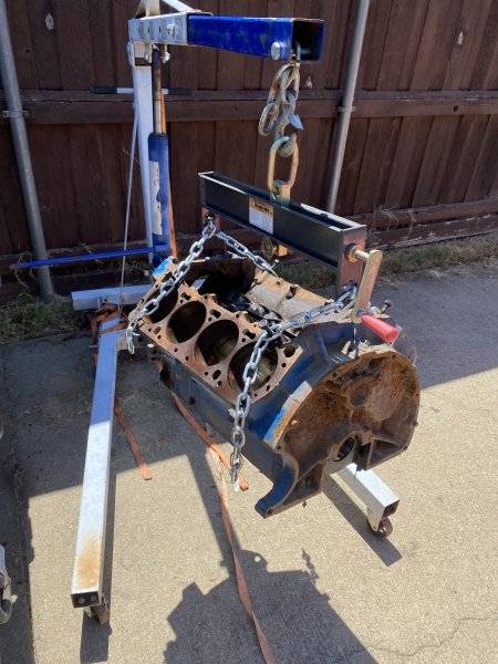

Some disassembly required. It doesn’t look as terrible as I expected, I’m hoping it scrapes by and cleans up at 0.035
