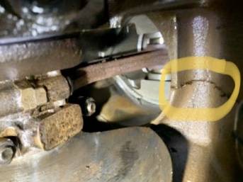

I just rechecked your pictures and agree that the rods look rusted plus is this a crack in the block?
Looks like a casting line to me.
The rust there doesn't look excessive, it's the bores that concern me.

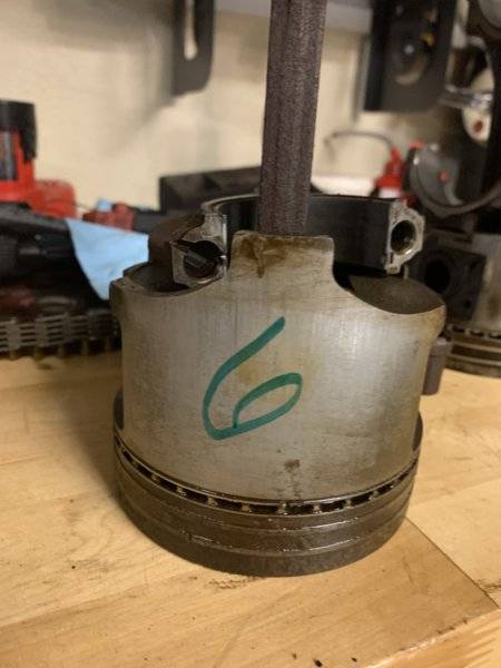

So the final verdict on this one is, can you save a seized engine......yes.....and no. lol. So, what I found through patience and patient advice is, just about everyone on here was right in one way or another.....
1. Head removal and piston inspection is a must. Period.
2. The rings going to be gummed up and stuck.
3. The wrist pins are going to be frozen hard.
4. On any of these cars that have sat as long as this one, its worth it ten times over to pull and assess original anything...

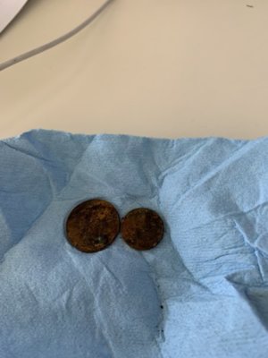

5. Finding a 1967 $.25 quarter and $.1 71 penny was boss.

....so in the end, this motor is going to the machine shop....but it really does look to be ok and close to standard bore. Crank and bearings look fine.
