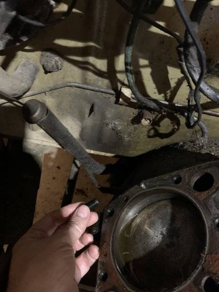

Well, got he heads off, and broke only one bolt.... guess which one, and why.....hehe
First one, tightened instead of loosened.
Just guessing.

Were you able to get the broken bolt out?

.....so as a sign that all is great in the Mopar universe, the busted head bolt, back left rear, presented a challenge that I was honestly not looking forward to this morning......but, as fate would have it, after soaking it in Deep Creep for 24 hrs.....it was finger tight....and came out in 3 seconds. I had a beer at 8:45 Sunday morning to celebrate. Is that too early?
Well church is at 9:00 here so yes a little early. The bore looks pretty good on that cylinder
Do you see any rust in the cylinder? It could be something else that’s keeping it from turning.
Cylinders had some very minor surface rust. It just vanished with a wipe of a shop towel...but from what I've seen and heard, its the second set of rings that can take a bit to break loose. Adding a shot of Seafoam twice a day to keep the juices flowing, and milled out a fence post to tap the cylinder heads with. I expect it may take a few more weeks of persuasion.
