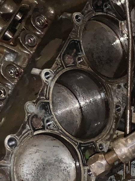

First picture that we've seen of the bores. Looks like some heavy pitting on the cylinder walls? Not the clearest picture but if the cylinder walls are pitted you'll need boring and oversized pistons.
PICs are typical Apple low light. Bores are smooth to the touch, but have a few light texture spots....breaking up with a finger nail. I've avoided any tampering with the piston walls other than mopping up with a blue shop towel.....seems to be working bit by bit. Rings should not be too bad, but they are stiff.....and this is what I expected. As the rings are designed to move independently with the piston, if any of them are fixed by rust withing their grooves ( I'm sure some are) they are whats fighting me....more MMO oil and Deep creep. What I do see from the crank socket manipulation is some brown rusty oil in pistons whose rings are probably free and are now allowing the oil to wash off the scale. Its kind of cool to try to sort it out this way. If not, I'll pull the motor and tranny and go deep.
