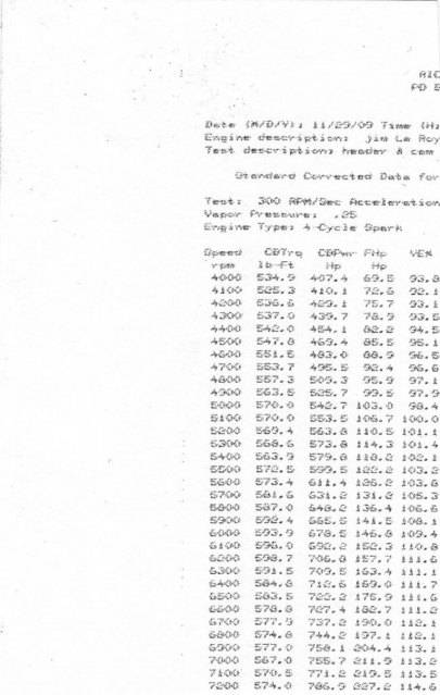

I don't know who's point this proves, but here is a 451 with 440 length rods (6.76 h-beam), forged pistons, a factory forged 440 crankshaft, ported Edelbrock RPM heads, single dominator on pump gas. The dyno had a hard time holding the engine below 3,500 rpm. It pulls 500 lb-ft of torque as low as 3,500 rpm and will carry that to over 7,500 rpm. And yes the dyno sheet says 786.9 HP at 7,200 rpm.
So if'n we're all building these things wrong, what the heck will they do if built correctly?
500 lb-ft of torque from 451 cubic inches for a 4,000 rpm range? I think it might work on the street and the race track. Guess we'll never really know until I learn how to build them correctly.
You posted A dyno run of a 440 is all you posted.
