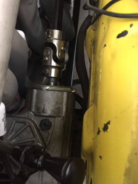

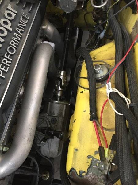

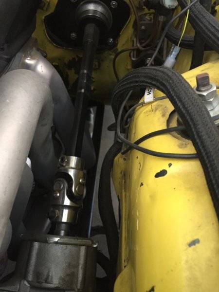

I’ll post some pics of my set up, that you will have an idea of it looks like.
Here’s some pics. Don’t mind the wiring, it’s done just for proof of concept. I’m here to help, so don’t hesitate to call.

Thanks I’m gonna pull my gear box and pump and list it for sale.
