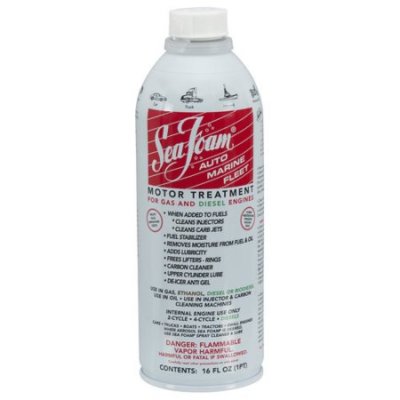

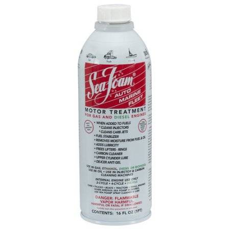

what is this mystery product i'm not aware of? any picture of a can?
Available just about anywhere.

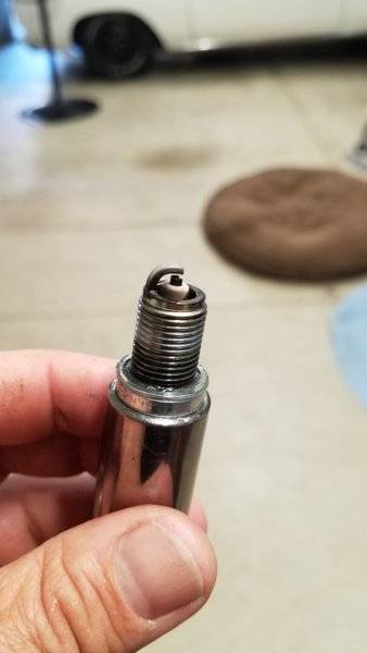

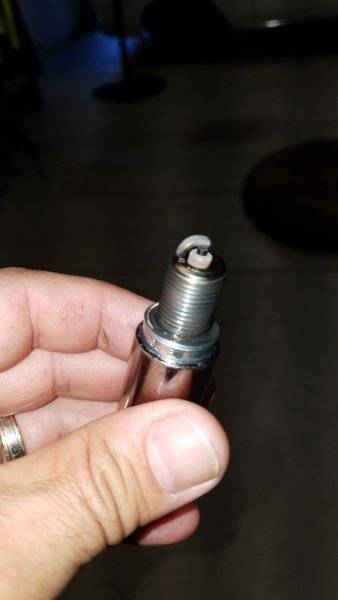

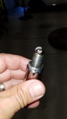

Ha yeah... well I definitely wasn't buying any claims of it improving power or restoring throttle response etc etc...but if it was just snake oil it wouldn't do jacksquat. Thanks for the tip on the water though, that's free and something I can easily try...
As far as it fouling plugs... That thought absolutely crossed my mind. Pulled a couple to check and it looks like we're all good there, thank goodness

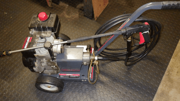

...........Speaking of the power washer, it’s a 20 year old craftsman...….
Lol, my '95. Slight pump leak but still kickin' (Available if ya' need a spare, cheap BTW) ....…...

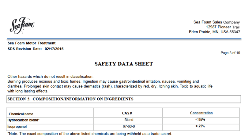

Hey beeper, for what it's worth, I got that formula right off of SeaFoam's own data sheet.

Actually, a safety data sheet is not the formula. By law, you have to report anything hazardous over 1% and anything that causes cancer above 0.1%. Anything non-hazardous (e.g. water) doesn't have to be listed. You can also list things as "trade secret" and only provide it to medical personnel (e.g. some idiot drinks it & is in the hospital). You can also list things as "blends" such as what photon shows, which do not require specific information to be listed. "Hydrocarbon cuts" like solvents, oils, waxes, gasoline, etc. are most often mixtures of tens or hundreds of chemicals, so no specific CAS number has to be listed, and even then, specific CAS numbers aren't "specific" with hydrocarbons, polymers (e.g. plastics) and some other groups of chemicals....whew, that's a mouthful.
Now Seafoam does have some isopropanol (aka rubbing alcohol) which allows it to act as a "fuel antifreeze" like Heet, and it is otherwise a blend of hydrocarbons....the exact blend being their "trade secret juice"
