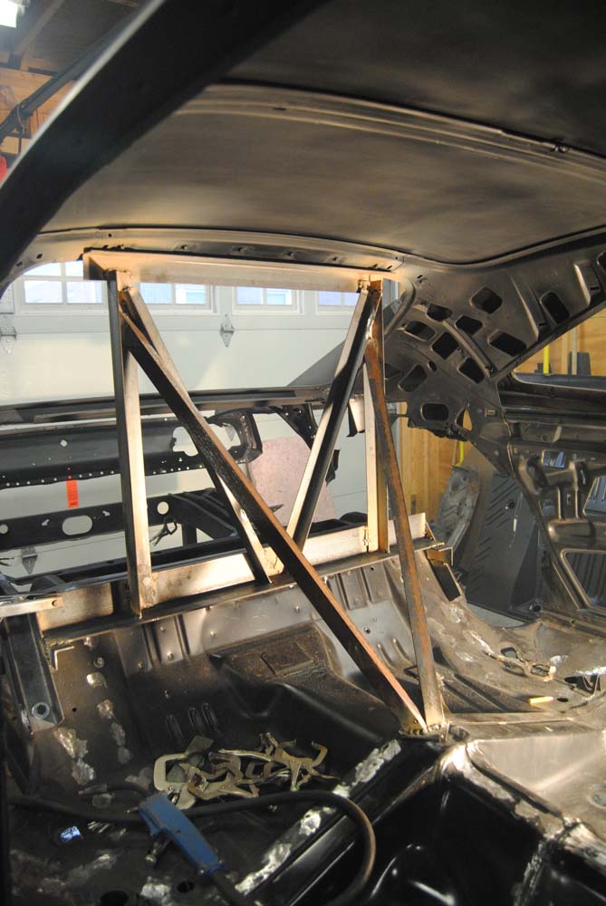

Hey All. Thanks for the comments! Been pretty busy at the day job and on a project for my church the last couple of weeks so no time for the R/T. Got out there yesterday and built a support for my roof off the car’s frame and got rid of the one off the dolly which would have been in the way of the wheelhouses. Nothing for the roof support is welded to the car. I bolted it to the seatbelt nuts and used a thru bolt at the seat pan’s center plug hole. Had to do a little jacking to get the roof to the correct height on the right.

I got looking at this pic of the roof support and got worried for a moment thinking how could I have forgotten to do this myself on my GTX? Then, I looked in my pictures and see that I solved this situation by welding a 1" sq pipe off the top of the rocker panel to the roof on each side -- sufficiently holding up that roof! Had me scared for a second there old friend!

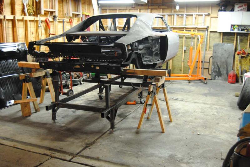

Hey Gang. Thanks for the comments. Busy couple of weeks at the day job, but I finally got my R/T off the dolly and put the suspension back on for its trip to the body shop for some adjusting. Looking forward to the North Oakland Mopar swap meet on Sunday! Hope to see a few of the locals there.

Good to see it on wheels. This is great news for me because the "DOG" should be painted very shortly then! Nice work Paul, see you Sunday!

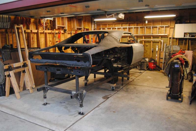

Thanks for the comments. Got the car back form B&B today. They put it on their frame rack and measured it up with the laser and found there wasn’t anything wrong. Weird! They gave me a print out showing the left and right lengths were off by 1/16” and the overall corner to corner to corner measurements were off by only 1/8”. All the height measurements were off by a 1/16” or less. I was told this is well within factory spec or maybe even closer then the factory spec. Not bad for a 1st timer at this level of tinkering. The trunk floor pan fit perfectly when I put it in for shipping to B&B as well. Still scratching my head as to why I had the illfitting trunk floor and measurement issues a month ago. :eusa_think: Must be a gremlin nearby. Oh well water under the bridge and time to start moving forward again.

Thanks for the comments all! It was truly rewarding to find out that the car was so straight and square based on what I started with. Still busy at the day job so crawling along with progress. This weekend I was able to get the suspension back off the car (getting pretty good at this) and back on the dolly. I cheated on the dolly leveling process this time and rented a laser level. Done in 15 minutes. Will start work on the trunk floor this week day job permitting.
