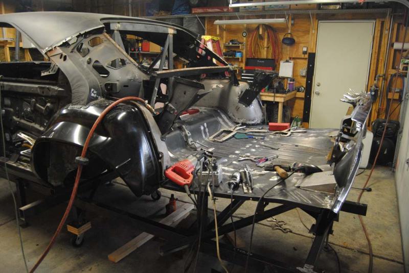

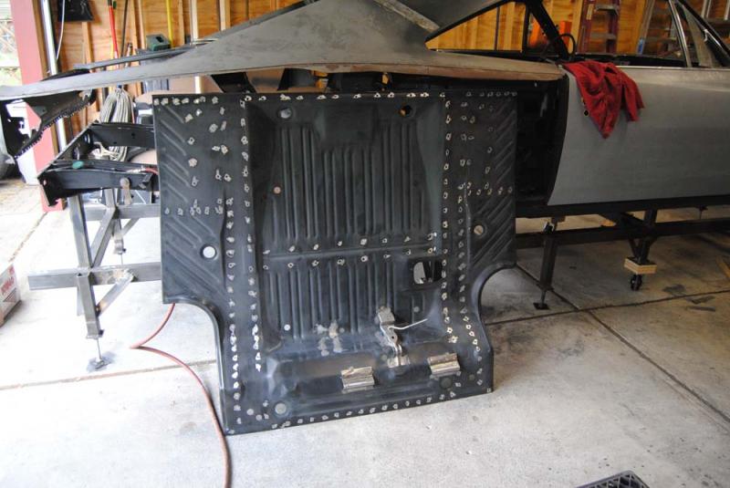

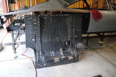

Trunk floor in
Hi all & thanks for the comments. Was able to block out a good chunk of the weekend and get my trunk floor installed. Still a little follow up welding and grinding to do but 90% complete on this panel. Progress pics below.

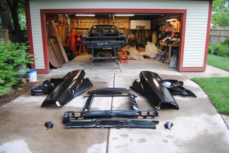

Christmas came early…
Referring to the pic below - some assembly required, batteries not included, no instructions, empty bank account….. Sound familiar? Wrapped up my project at the day job so now I get to work normal hours and get a little time with my R/T. With all the new parts I had to do a little organizing so things would fit in my basement which is looking more like a car part warehouse every day. Wrapped up the welding and grinding touch-up on the whole car so now I’m ready to start on prepping for the new parts.

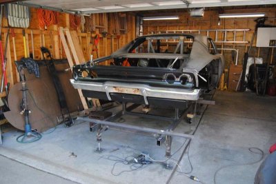

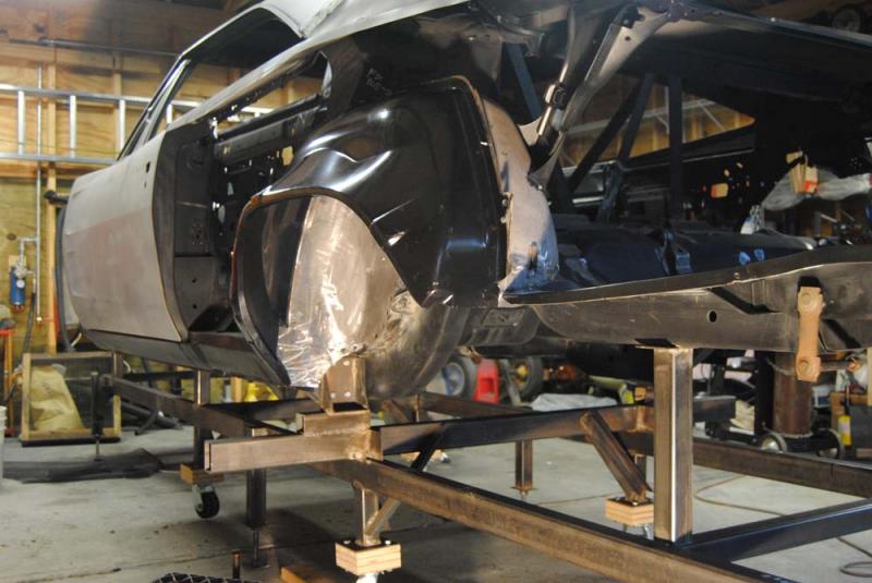

Thanks for the comments. This week I was able to get the rear valance, tail panel, and associated bumper reinforcements fitted into place and ready for welding AFTER all the pieces are in place. Learned that lesson already. Had to move the rear support from the dolly forward since it interfered with the rear valance. A loose angle across the dolly rails makes a nice platform to measure from. Started fitting the wheelhouses but the inner replacement ones are not that great of a fit compared to sliding the old ones in (glad I saved those). Debating on fixing the old or cutting up the new. Donny gave me some good suggestions on how to proceed (fitting it to the quarter and cutting the wheelhouse as required). Also found a thread on the charger forum which has similar info. Progress pic below.

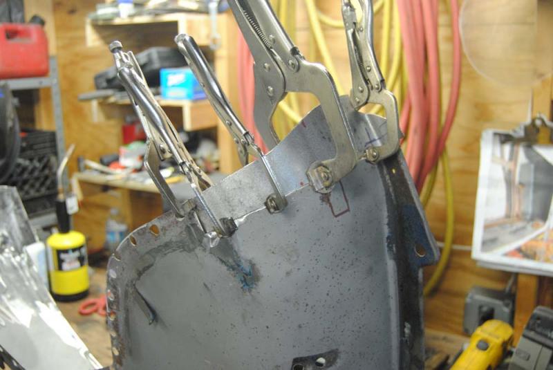

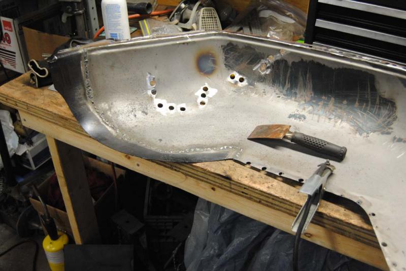

This week brought more trial and error with the rear wheelhouses. I gave up on trying fitting the new AMD inner parts in and when ahead and repaired the left inner. The new ones were not fitting well at the roof and deck lib filler panel supports. The old ones fit like a glove and give me a great benchmark as to where they should be located by aligning the holes from the spot weld cut outs. I was able to fab up the pieces for the left side repairs, but will be cutting pieces out of the new right wheelhouse for my repairs due to the more extensive work needed on the shaped portion of the part. Got the left side set into place and started on repairing the right inner. Awaiting a new right outer wheelhouse. Factory marked a left a right and then replacement sent out was for a Plymouth. Hoping to have a right hand dodge one this week. Progress pics below.

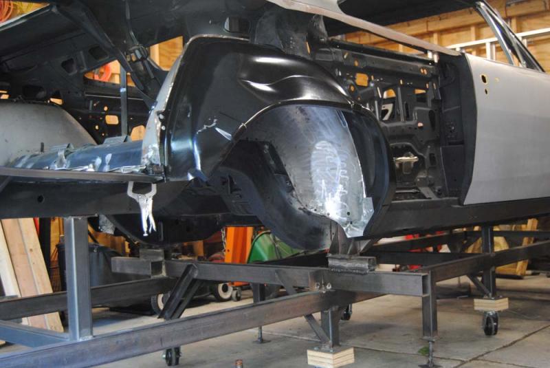

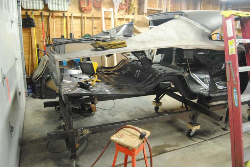

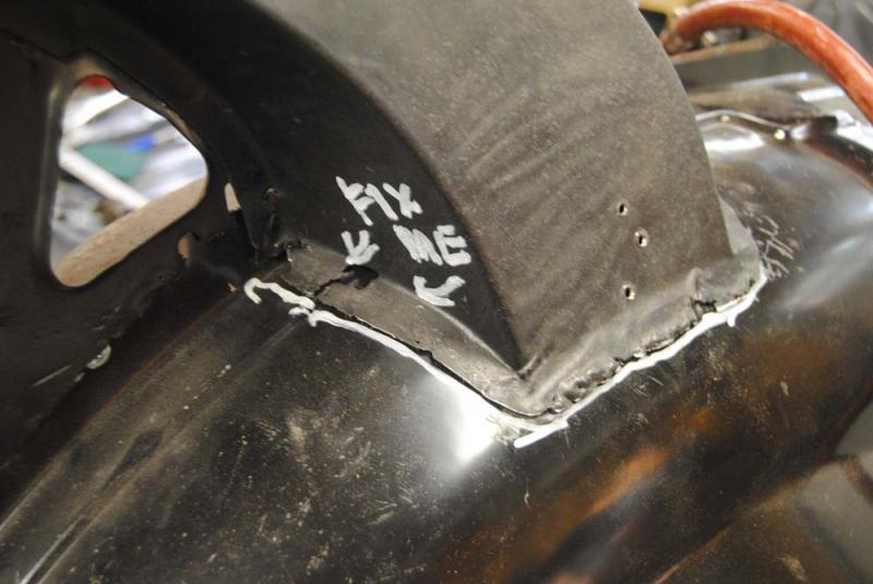

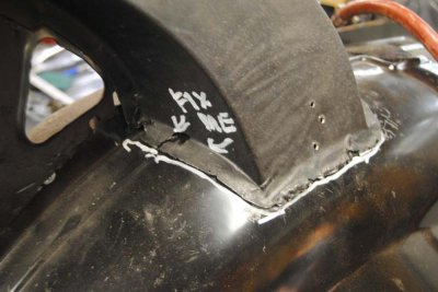

Pretty sure this is the last metal to remove – I hope.
Thanks again for the comments. This week I patched my right inner wheelhouse and my correct right outer wheelhouse arrived and I installed them. I spent most of the weekend removing what was left of the old quarter panels and deck lid filler panel. Discovering more questions with these last panels removed. The right panel was replaced at some point and doesn’t have all the small brackets the original one on the left did. In communication with AMD to identify if what is on the new panels I bought will supersede what is on the car. Ofcourse the people who did the previous body work mucked up more things for me to address…. I’m putting notes on the car so I don’t forget to patch things…. A few progress pics below.
