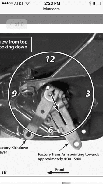

im putting in floor shift. Is trans arm lever all the way towards engine park? What's the pattern? Thank u 727 tf.
727 auto
All the way front at trans.. A bell crank needs to go vertical threw the floor to make it work right.
I'm putting in a hurst quarter stick. It was a column shift car originally. Thanks
lots of different trans levers available for both shift and kickdown
get the one that matches your shifter
hurst instructions should tell you or ask here
So the main shifter arm in park should be pointed towards the driver rear tire roughly. Park is not with the arm pointed at the driver side front tire. Aka. All the way back is park. All the way forward is low. Correct?
