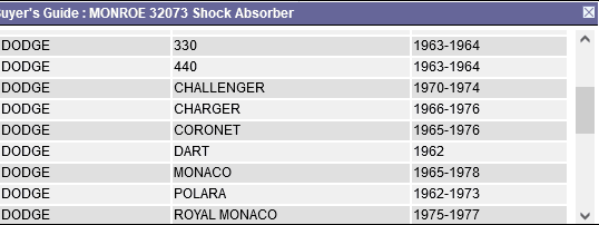

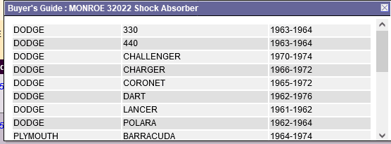

What year and model car? If you look at the applications it will tell you the years that model shock was used.

Maybe any shock between 65-76 will fit. Thanks Pnora! I’ll try those Monroe’s and if they don’t feel good I’ll try my luck and see if a later B bilstein fits.
