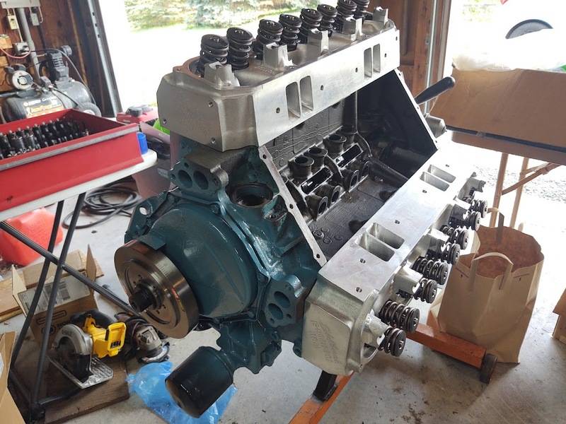

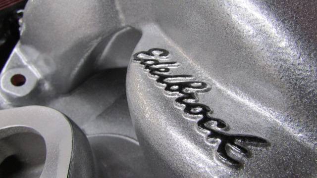

I have a set of Edelbrock E-Street Heads I bolted on my 383.
They look like new now but I'm sure eventually they will become chalky looking.
Suggestions?

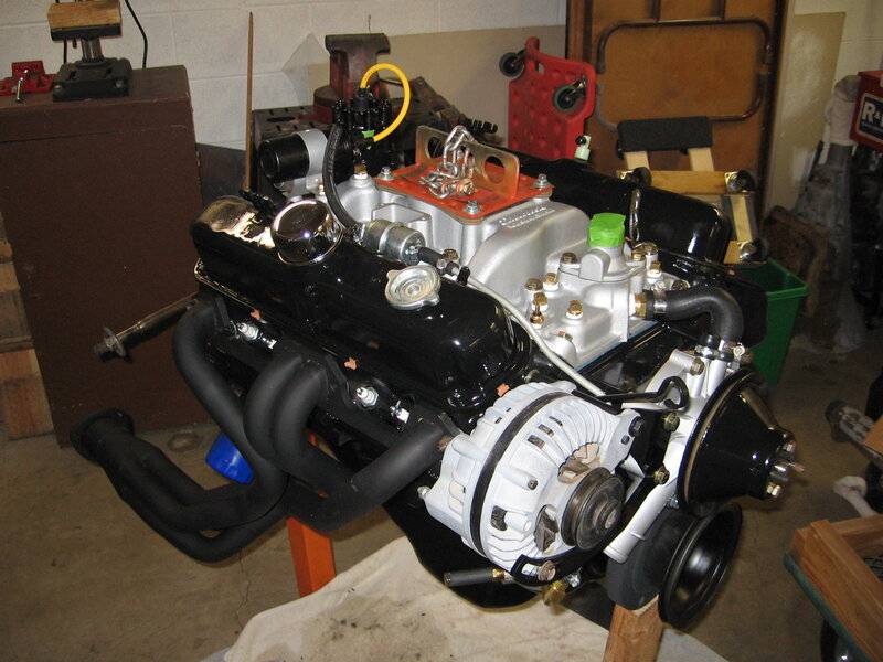

I primed my aluminum heads with self-etching primer and painted them with the engine. 2,000 miles this year and still look as when I painted them.
I'm not adverse to painting them engine color, just afraid if the paint does not adhere in a few years it would really look crappy.
Scuff a little before using the etching primer, then paint. They should hold up good.

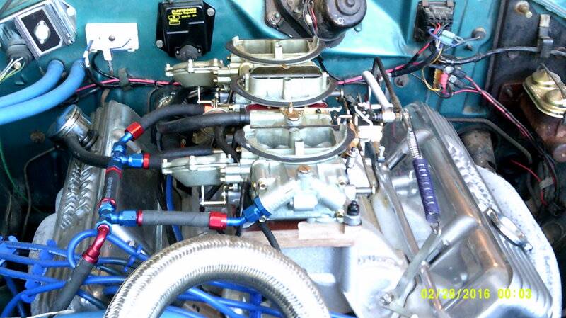

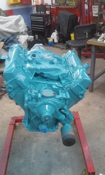

This intake is painted with Rustoleum High Heat engine paint.
Looks just like natural aluminum. This is when it was fresh but is going on 5 years now.
Holding up very well. Also fuel resistant.

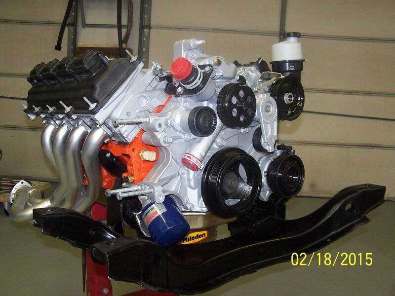

I did the same with my Hemi intake.
Either way, good advice here. Engine color, or aluminum color. Your choice. But paint it. The natural look of the aluminum will become crappy looking after awhile. I know, because I made that mistake in the past.

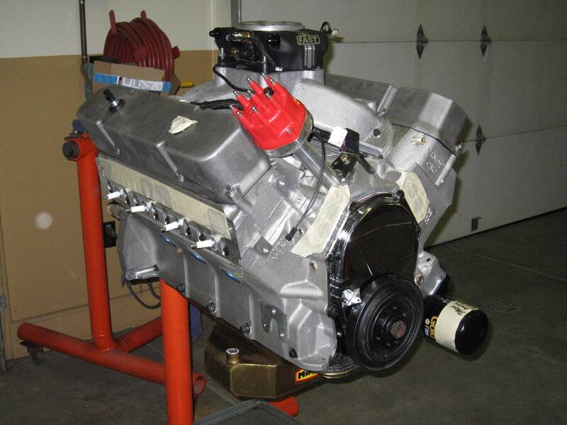

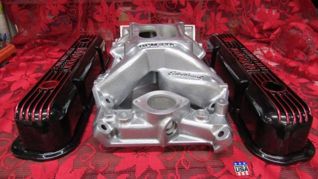

I don't do a ton of buffing / polishing here but have been VERY happy with the results and lifelong protection of MC-160, one of many clear liquid ceramic coatings available from Cerakote (https://www.cerakote.com/shop/cerakote-coating?series=cera_clear). Though available in larger quantities, a 4 oz. "tester" bottle is more than enough -- a little bit goes a long way, and you can even pour the leftovers back into the bottle. All you need is an HVLP gun with a .08 mm tip ($18 on ebay). There are different formulations for different metals, shiny or matte finishes, air cure vs. oven cure, etc. I used to use clear powder but am so impressed with the clear ceramics I rarely even use clear powder anymore.
It's the final coat on this intake and these restored Commando valve cover fins for the famous GoldFish (read as no future polishing or touch ups EVER) while providing enhanced chemical / UV protection and increased durability.

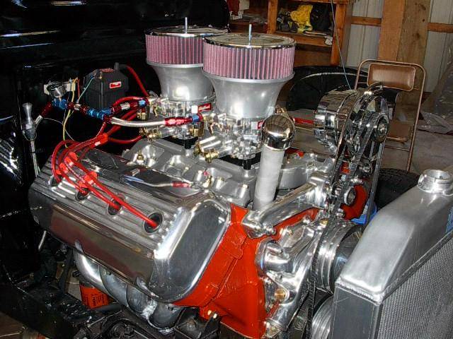

I like the natural aluminum look
I've left all my aluminum heads natural (many are Edlebrocks too)
most all my intakes, water pump housing, rad. or valve covers
have been too
not much oxidation, if at all, I'm in a decent climate
& we do actually get all 4 seasons up here, with no salt on the roads
going on 15+ years now
(no leaks helps)

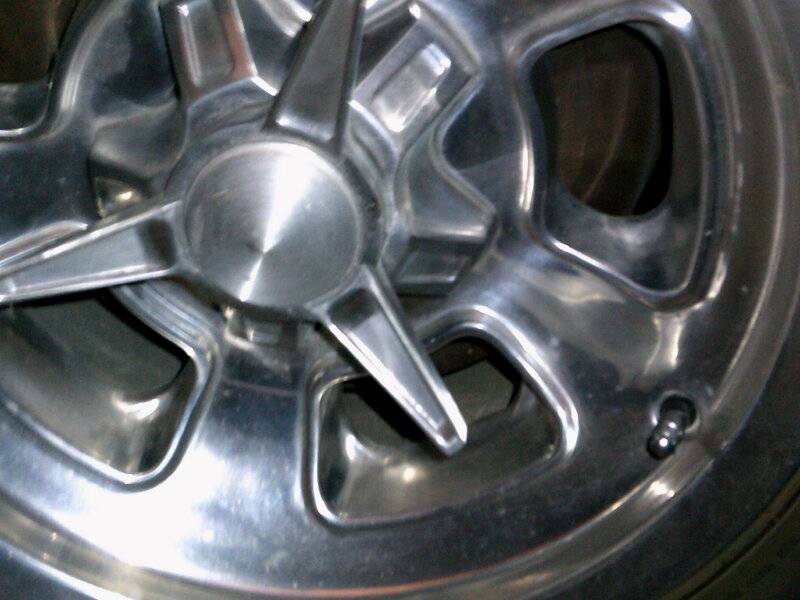

one of my pet peeves is painting trick aluminum parts
transmissions, water-pumps, radiators, heads, intakes, valve-covers
I like the natural/mechanical as cast look of the aluminum, or polished
partially why I purchased them
as long as they don't look like crap to begin with
(sorry to anyone concerned, it's just my personal preferences)

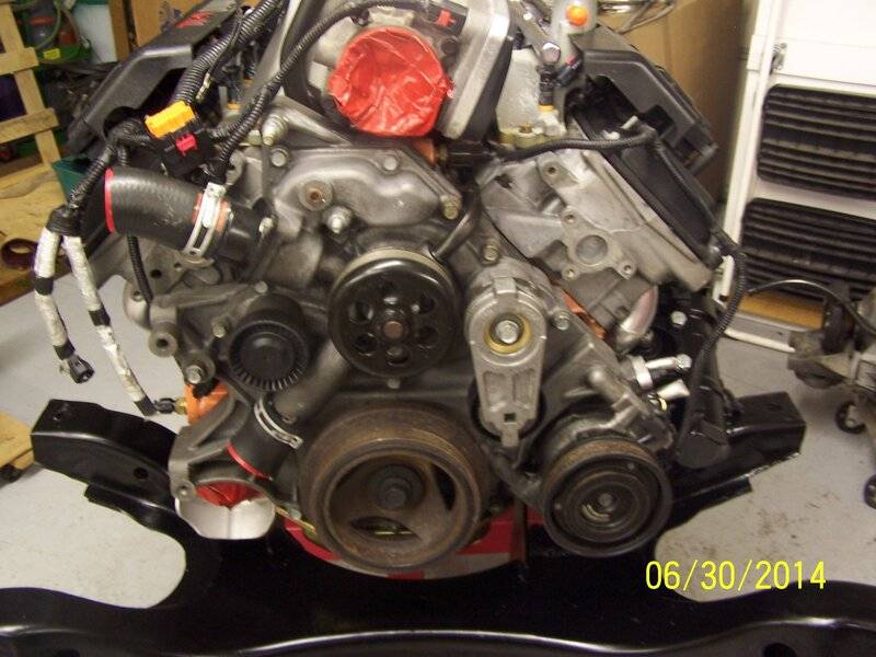

I agree........Here is what my 6.1 looked like when it came out of a 06 SRT8 with 34K miles on it. Bare aluminum likes to get chalky and don't clean up very well.
